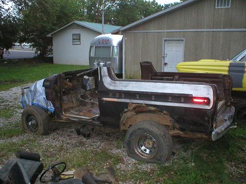

started the tear down today. got all the front end off and the wiring out. I get to use my favorite tool tomarrow.......sawzaw and BFH

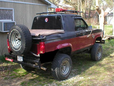

nice freakin falcon i love thows old car's if i were ever to get a old classic like that i would get a 67-68 fairlane or a old comet. save your part's you can sell alot of that stuff ( doors, tailgate, brake booster, hood, ect), and make some money back might take awhile but it's worth it. does the f-100 have a heathy motor? i got more pic's of my rig's steering and body mount's so if you need something let me know.

I will probably be hitting you up for some more pic's next week, I plan on installing the BII cab on mon. how did you get your cab on the full size frame? I was planning on just buying the beer and having about 6 friends set it in place.

the cab swap will take at least 4 people. my cab was gutted and top choped and we raised it over the chasis with motor and drive train still in place. the chasis also had a 4" lift, 6 of your bud's should have no problem.

I have it down to the 8 body bolts and the roof is off now. planned on just cutting it down the center and just kicking off both sides. I am going to scrape and reundercoat the frame while it is off. I figured I would mock up everything up with the 351M in it so I will have some room when I swap the 302 in. I was thinking of using the FS column on the BII and just wiring everything up with the FS wiring harness. did you use the BII wiring?
i had 6 or 7 of my buddy's over to remove the 79 tub. it's heavy (muther). or you can just roll it off. i opted to lift it off becuz i had a trailer to load it on to get rid of it.
when you mock up the body make sure to leave as much space for a nice size radiator. i mounted the firewall as close to the cleveland as i could get it to go without making it to hard to get to engie/tranny bolt's.
i used the 79 wiring harness. take the whole thing it's a pain in the a$$ to remove but it make's hooking everything up easy. make sure to take the headlight wiring harness to. i did'nt keep any of the switches for all the accessorys becuz im gonna gut the wiring of all the stuff im not gonna use and wire up my own switches for all of my accessorys. i used the broncoII steering column becuz it fit. the 79 steering column is gonna be a biat*h. you'll see.

I am almost done getting it all taken apart, I just have junk laying everywhere
I have been doing alot of thinking about that. I would like to keep the wheel base of the 79. so..... I was thinking about putting the cab on and making the decission then. I think I might just chop the whole rear of the fenders out and leave the wheel base if the frame doesn't look to bad. kinda like I did in the pic.
