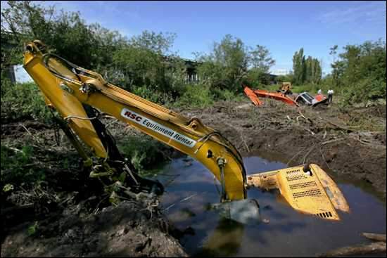

I had a yard out a couple stuck excavators......
isnt that the guy that rented one and got it stuck and is now stuck paying for it?
yeah, that's right by where I live. Pretty funny. Last I heard, I they brought in the big toys and have recovered one of them.
