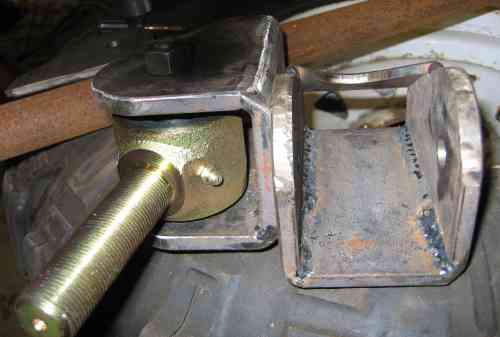

I got the rear tore apart (the rear end was out) starting with removing the skid plate, tank skid plate, fuel tank, both pumps, links, coils and removing one upper frame mount and made what you see in the pics.
I am also going to redo the fuel system since I am not thrilled with the fuel lines I used when I did the FI swap. Longest part was getting the 15 gallons of fuel out.
Old upper frame mount, stock Ford part
New upper link end
New upper link end
New lower mounts (not atached to the link yet)
New frame mounts I made
All 3/8" material except the top gusset is 1/4"

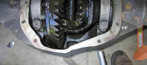

I got a bit more done today, nothing to exciting. Cut off the other upper mount from the frame, bent up the upper link mount, welded it to the 60 (without tying it into the pumpkin yet) and did a bit of grinding to decide if I wanted to cut and shave the housing. I decided that grinding is enough, cutting and plating would only gain me about 1/4" more unless I ground the ring gear and I don't want to do that.
I will be making a cover and adding a bolt hole to keep the cover from peeling. The plan is 3/8" ring that will tie into the link mount, 1/4 over the ring gear and 1/8" for the rest.
