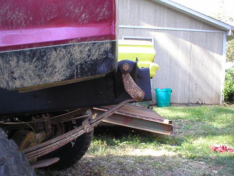

the front is stock, they compress to about 13" with the weight on them. the rear hangers are just flipped, with the front holes being used. so the shackle is on the hanger at the top of the frame, and the leaf connects at about the bottom of the frame. here is a pic of the shackle:
I didn't weld any thing I just bolted it up. are you talking about moving it completely under the frame rail?
