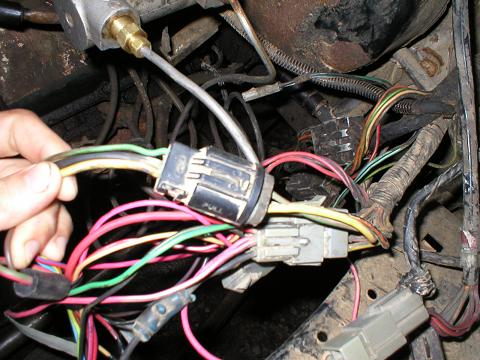

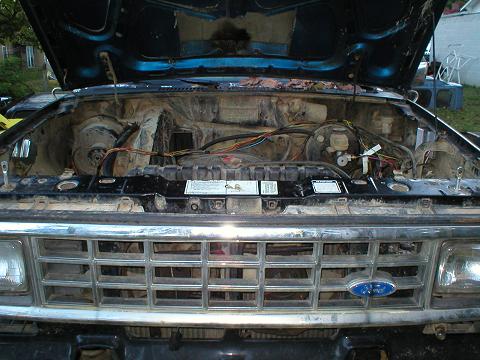

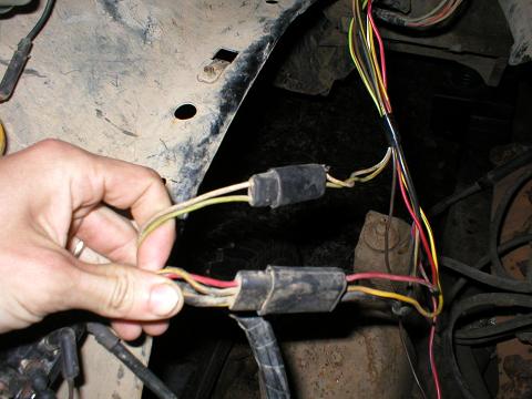

ok, in the first pic you will see the 2 clips coming off of the 79 harness. the 2 plug clip I am pretty sure it is right because I know that they were wired to the ignion on positive wire and that is how I hooked them up. I also know they need to get power or the alt. will not charge. so the only thing I am up in the air is the 3 prong clip. the large black wire goes to the alt and the yellow wire goes to the alt. but the red goes to the pos side of the selonoid(constant all the time).
in the second pic you see the clip coming out of the firewall that clip went to the old altinator. it had an internal voltage regulator.
I think the two larg black wires will go together(one form the BII clip to the one on the 3 prong) and the green wire (form the BII)will go to the yellow(from the 79 harness). I think the left over wires can be left unpluged.
so what do you think?

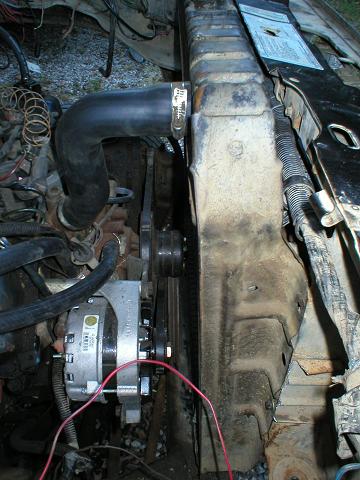

but anyway, I got the rad. in electric fan is in so the only thing I got to do is find a lower rad. hose and I am ready to go. the factory 351M rad fit like it was ment to be their. the front end is back on it and it is starting to look complete again. I am going to take the day off tomarrow and go to play golf, but I will be back on top of it on thursday so I will get y'all an update then.

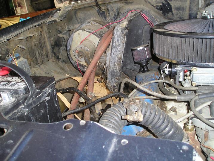

had a few minutes so I figured I would get y'all some pics.
well, close only counts in horse shoes and hand granades it got about 3/4" - 1" clearence. I think it will be enough. the only part that is too close it around the strearing box, it is just slightly touching but I can grind off where it is making contact, so I'm not sweating it.
