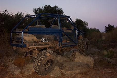

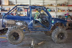

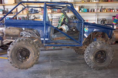

well i have been working my tail off! i dove tailed the front and move the rear axle back and move up the gas tank. moved the battery. and many other things. here are alot of pics. starting off with the stock lenght BII.

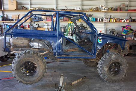

now her is a pic of how it looks now!

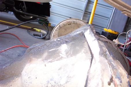

what i did was flip the leaf springs around to gain about 5 inches. I was also going to have the axle out so i shaved off some of it.

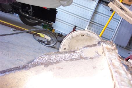

and what it looks like now!

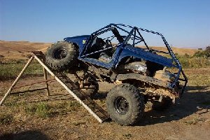

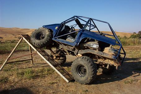

now here it is flexing its got more flex then befor but it still scores the same on the ramp because of the longer wheel base. You should also know that this is a 30 degree ramp!

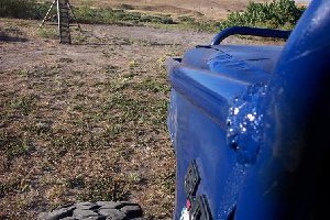

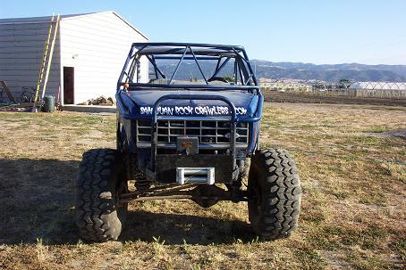

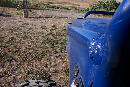

here is what the front looks like now with the dove tail.
anouther one from the side
the top pics have the dove tail in them to so you can see it from the side there to. this is waht i had to do with my oil filter and catcher for the radeator.

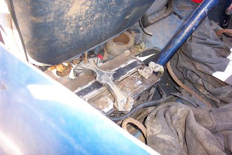

this is now were my battery rests. i had to put it behind my seat because there was no room for it under the hood.

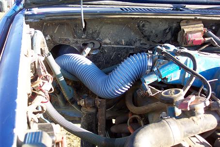

this is my redneck intake setup. thats a shitter tube off an RV dump. You know you get them cheaper used then new :puke:

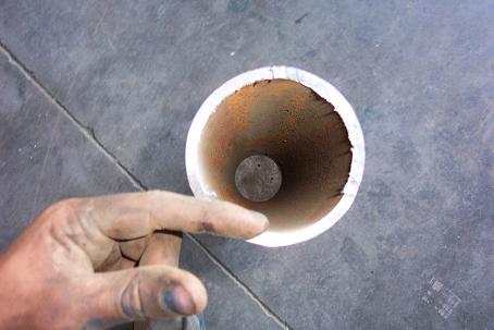

i needed to build a new rear drive line and found this metal! its really think and big i will never be able to distroy this driveline!

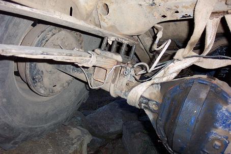

what the suspention looks like under flex. The leafs act alot better now that the clamp is in the back. there is less axle wrap and they dont bend all up like the did befor but we will see how long that last.
testing everthing out!
and the last pic for now. i have 21 hours into the rig sense i started the front dove tail 3 days ago. i have worked my tail off and i still got some more to do!
