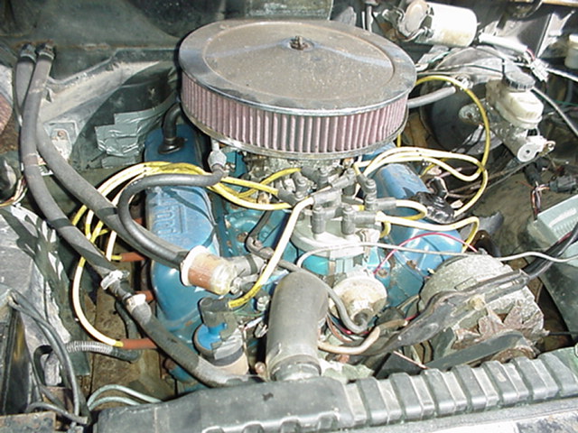

if i were doing a EFI swap, ide have a donor rig,then you have everything ya need
Re: 5.0 Install
I have a mechanical fuel pump, don't know if it will fit my block though. I also have the intake, I'll just need a carb and figure out what to do with this damn distributer.

Is that the piece on the timing gear? What would I all need to do that? Would it be cheaper to get an electric pump and regulator?

its bolts to the cam gear. electric pump is easyonewontwo wrote:Is that the piece on the timing gear? What would I all need to do that? Would it be cheaper to get an electric pump and regulator?

Are there any pumps you recomend? I'm going to go with a carbed setup for now. You talked me into it.

if you go mechanical pump ya need a different timing cover. i think you can leave the in tank pump. i think if it were me i would use a inline elect. pump. that way ya don't have to hunt down a cover and the eccentric
