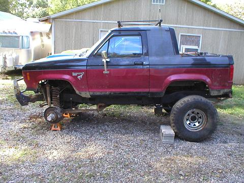

well, here is some more eye candy......

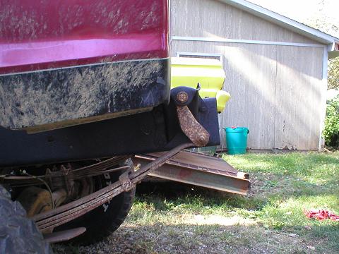

I got the rear almost done:

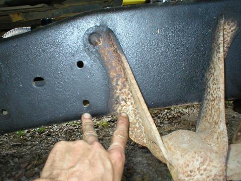

I think I still have to move something though. if you look at this pic you will see the hanger is at. it seems a little tight. I think I might have to move the front hanger forward about 2" by using the hole in front in the second pic.
because of the angle it is at I might have gotten .5"-1" when I get that angle straightened out I might get around 2". I didn't know if fliping them would bring the hangers in far enough for me to be happy but I think it will work ok. it just seems like I can get it on the road for less cash and it will still flex ok with the leafs. I am still wanting to do the coils in the rear but I think I will wait just to see how I like what I have. next week I plan on getting the fuel cell and wiring situated. my goal is to get the truck done by christmas, but it would be nice to get it done before it starts to get cold here.

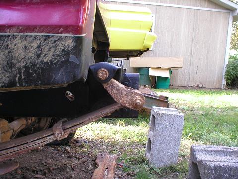

well, I can now say the rear is done! the hard stuff anyway......
basicly all I have to do is get some shocks, and have the driveshaft shortend about 2" but it all worked out great. the only problem I ran into was my angle grinder decided to break as I was cutting off the last riviot. now for the front........
