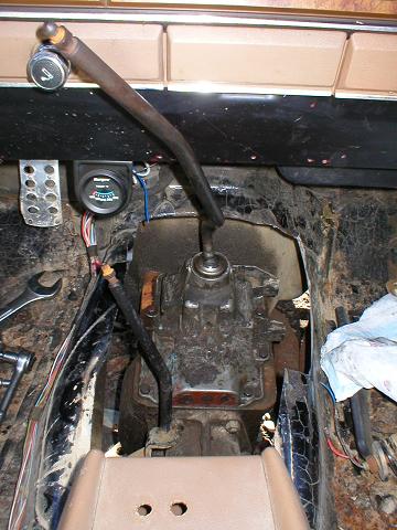

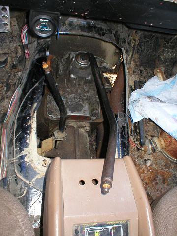

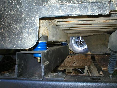

well, I worked all day........
this is what I got done:
body mounted
cut hole for trany and transfercase shifter
installed both shifters
hooked up speedo cable
wired the tail lights
here is a pic of the mounts:
here is a few pics of the tranny......I put it in 1st and 3rd and they both cleared everything.

Man that mount looks sweet!I take it you are going to keep the stock full size wheel base.Since you said that the spring hanger was behind the tail gate,am I understanding that right?I think D-diesel said something about moving his rear axle forward 10 inchs or something like that.What I was thinking of doing was to set the firewall as close as possible to the tranny and move the rear axle to keep the tires in the wheel well.porabaly have to cut the front fenders from the highest part of the opening streight forward like the old flat fender jeeps.I really dont want to try to stretch the b2 body.And I guess you could open up the rear part of the rear wheel well a little.Looking good so far man.I wish I already had the b2 bought so I could spend the cash to come down and look at what you have done and bring my tape measure of course,that is if you dont care if I copy what you did LOL.Save me a lot of trial and error LOL.
