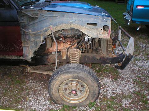

here is the front. the angles look almost the same.

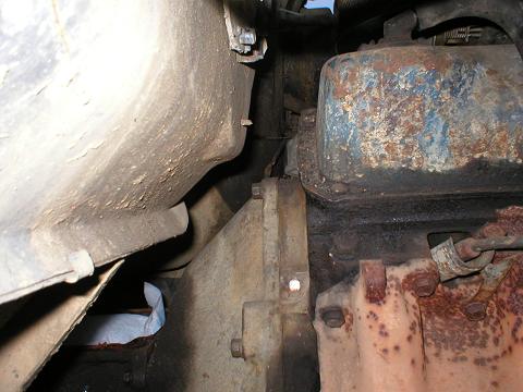

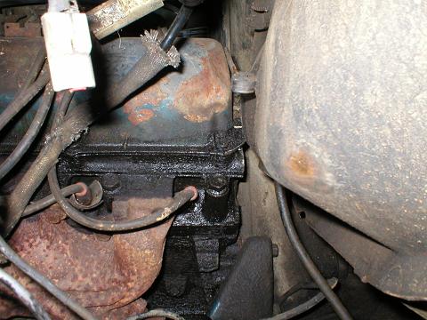

here is a few pic's of the motor next to the fire wall.
it looks like the firewall is bubbled out on the drivers side, so it is a little closer to the valve cover. I think once the 5.0L is in it will have enough clearence. I have checked the frame and body with a tape and it seems to be centered well. the body will be a little lower because I used the body lift blocks to set it up where it is now. they will become history as soon as the new poly bushings get here.
:hmmm:!!!! look's familiar :finger: there are alot of thing's im gonna do over. you've got the idea though with taking your time. i wanted to wheel so bad that i did whatever popped into my head (well not realy but close). lot's of room up front for a winch. if i had it to do again i would'nt have cut so much off the front of the frame. second i would have stretched the body in the rear a little. all in all im happy just have to get my suspension completed and next is the front a rear bumpers which will just consist of some flat stock to close up the frame. then a cab exo.
looking good though cant wait to see what she look's like complete. :cool:

DBrown wrote:here is a few pic's of the motor next to the fire wall.
The heads are offset slightly
