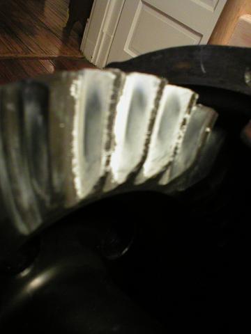

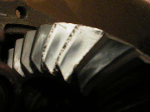

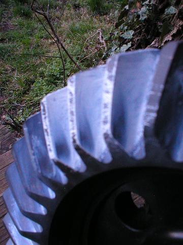

well, I pulled everything apart and I double checked everything again. I put the races in by them selves with out the retainer just the races and the retainers still didn't tighten down all the way. the races were tight in the housing though.....I guess I will just have to pull the other housing and check it.
the pattern changed when I put it back together, the pattern is more centered.
here is a pic:
here is a pic:

Looks like the pinion needs to be a little deeper now. Did you set backlash?

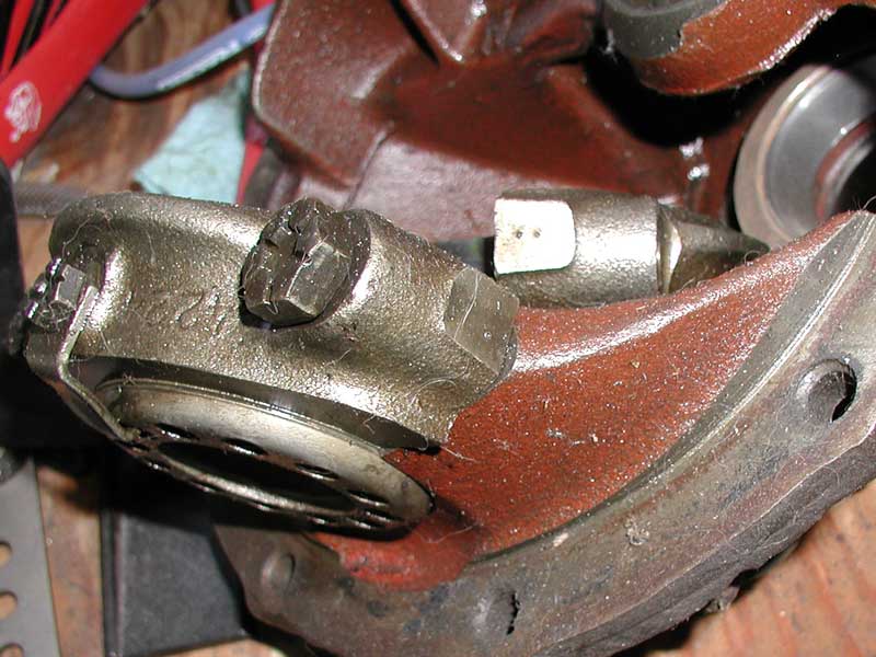

In the pic below, notice how my bearing caps are marked with a single dot and, and double dot. There are corresponding dots on the 3rd, so you get them on the right side in the right direction. The can be marked many different ways. Does yours have any kind of markings?
yeah, sorry.......BL = 8 PINION .038

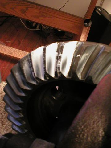

well, I know this post is old but where is my second attempt with the second housing.
pinion depth = 26(I tink it was an hour or so ago)
BL = 8
BL = 8
the bottom pic is kinda hard to see......the pattern is actualy a little wider then it looks. the coast is a little close to the toe but I am afraid to put it any closer because of what the drive side looks like. the drive side is nice and centered and large.
It looks like you've learned a thing or two.
I don't like the coast side, I think it's too high on the tooth. Drive side looks pretty good.
This one is a tough call. I think I would go a touch deeper with the pinion, .023" or so. I think in some cases it's acceptable to play with the BL for fine tuning.
cool, I think I will give it a try in the morning and post some more pics.

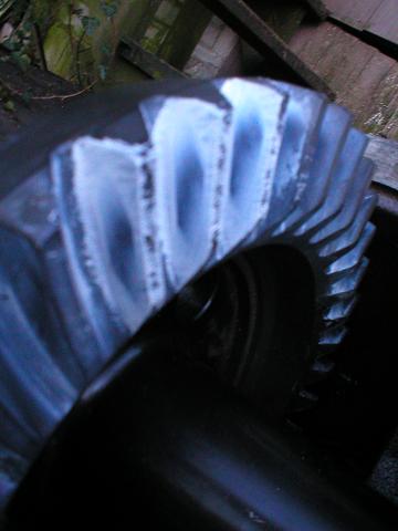

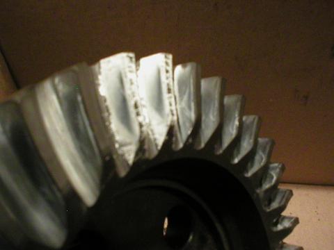

ok, you were right......
I was off a little on the last post I was at 21 on the pinion depth, so I lowered it and this is what I got. the coast side is still to the toe of th tooth but it is looking a lot better....covers about 75% of the tooth. the drive side is still looking good but it is moving tward the heal of the tooth as I move the pinion closer to the ring. I think this might be where I stop.
pinion depth: 18
BL: 8
pinion depth: 18
BL: 8

thanks for all the help with this, now if it will just quit raining so I can reinstall.....
