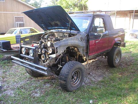

I will pull some pics in the morning. I got all of the front pulled off the BII except the fender wells, seats are unbolted, and all the wiring is out. I got to call my friends in the morning to get a group together after they get off work and lift it over on to the 79 frame. I was thinking of swaping over my BII driveshaft to the 79 and setting up the rear to that because it is in good shape and it will cut some cost off the top. I don't know still tossing that idea around.

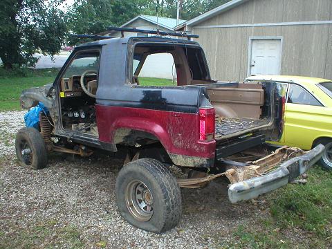

here is the pic's I promissed. got my metal list together, going in the morning to get everything and start fabing the body mounts I don't think it will take that long. I'm going to do mine a little different then you did yours though. I measured out all the bodymounts on the 79 and the 86 and then marked and maped out where everything is going to go. going to use 4x4 square tubing and some angle to bolt everything on. I talked to all my friends and they are comming on mon. to drink bear and move the body over. basicly going to take the entire day tomarrow to get the 79 frame ready. including a fresh coat of under coating.

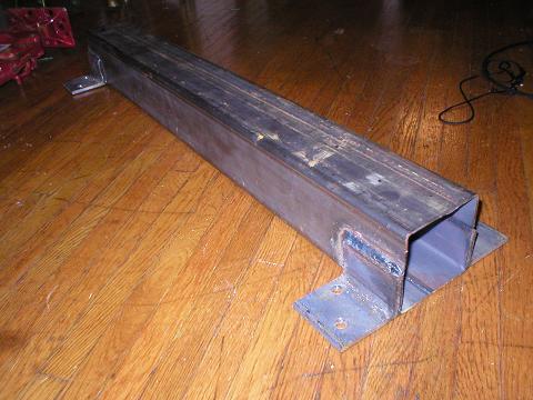

well I got all the body mount pieces cut. just got to weld them together. if it wouldn't have started raining yesterday it would have gotten done. the frame is all ready and waiting on the mounts. I will probably not get to weld untill mon. morning so I will probably post everything at one time.

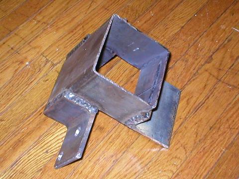

here is a picture of what the center body mounts look like.
here is a picture of the rear bodymounts. I just left them connected so that it would help keep the frame tight like with a crossmember.

well, right before I left the house a few friends came over and I talked them into going ahead and just doing it. the 3 of us got it half way off and dropped it! after getting it back up and on the new mounts it fit perfact. now I am just waiting on the new body mounts from duff.

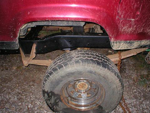

here is a pic of the rear. you can see about where it is going to end up.
