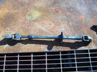

I am starting the steering next. went to the pick and pull today and got my steering junk.

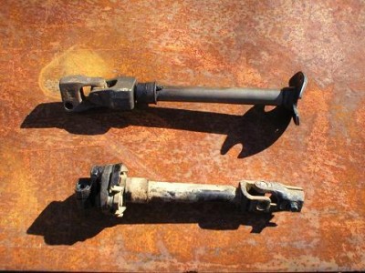

in the pic you will see the 79 steering arm on the top and the steering arm from a 90 ranger on the bottom:

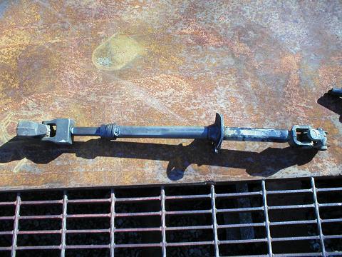

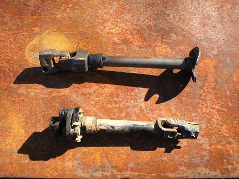

in this pic you will see how I am going to connect them......kinda:
basicly I am planning on sleaving the two pieces together. drilling and running a bolt threw both ends on the sleaves then welding them at the joint for double the strength. this should give me exactly the same thing that the $225 piece will except the fact that you can replace the joints and it will be a little weaker......but I have never heard some one tell me that they broke one of these pieces unless they were worn out. got the 90 ranger piece for $20. so expecting under $30 for bolts and everything.
how did you get the rag joint off? didyou cut it? i might have to invest in this keep us posted on how it works' out. now that i think about it that shouls be just like mine except i used the rag joint. i'll have to look at it again.
