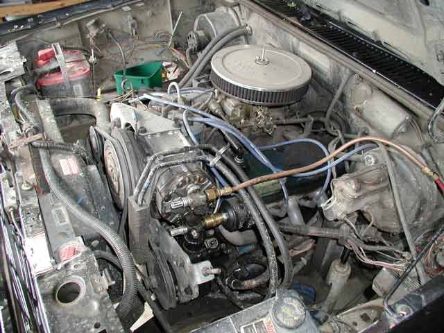

Lots of pics here.
http://www.broncoii4x4.com/v8swap/302swap.htm
These are more recent. I moved the radiator forward a bit so I could run a different fan.
Also check out Broncoo's rig here
http://forum.broncoii4x4.com/bronco-ii-776.htm
