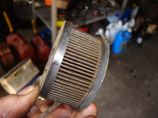

theres a filter in that canister, this filter was so dirty my truck would only idle

stupid question. air filter? Dave's right sometimes the canister has one, sometime not.
Re: 87 B2 MYSTERY PROBLEM! HELP NEEDED
it should have one,its the only filter in the system

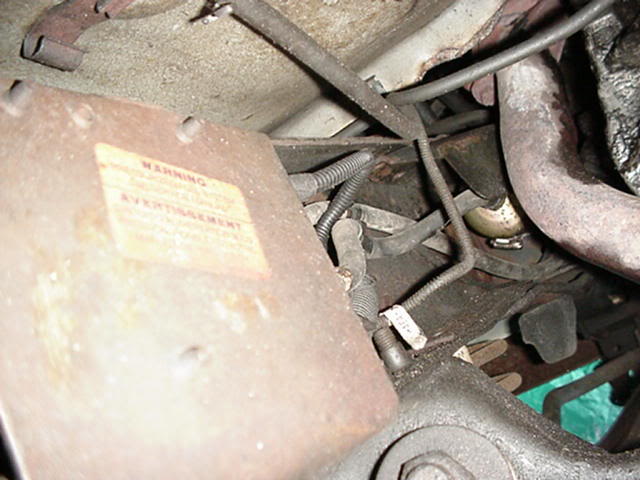

87 didn't have another one on the frame rail?
B5150
Posts: 17
Joined: Sat Jul 23, 2011 9:47 pm
Location: utah
Post by B5150 »
its injected for 1. an the metel can lookin one is close the the engine bay. the part store said i have two filters. the metal. an paper one but i cant get that black canister open for the life in me. but looks like it should open
nope, my 86 ranger only has a filter in the canister,my 88 B2 has the canister and a filter in front of the HP pump
B5150 wrote:its injected for 1. an the metel can lookin one is close the the engine bay. the part store said i have two filters. the metal. an paper one but i cant get that black canister open for the life in me. but looks like it should open
its hard to get it open, but it does.maybe starting in 87 ford went with 2 filters
