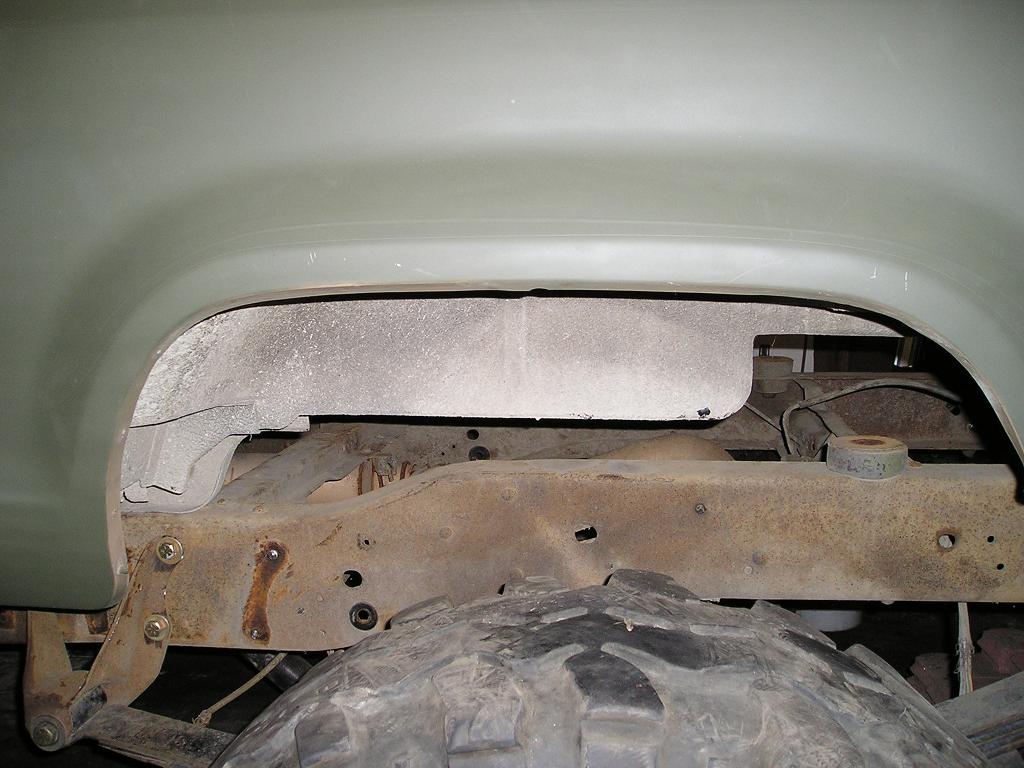

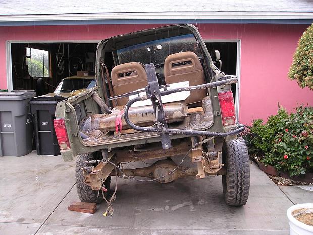

1. the stock wheel base on a 78-79 bronco is 104.7". i moved the rear end up about 5" (it's easier than it look's). i did it by myself in about 2-3 day's dew to all the drinding of rivet's. i wanted to keep the 104.7" wheel base it came with but i did'nt have the time to strech the rear end of the b2 (lot's of freak'n cutting/welding). also i thought it would take away from the over all b2 look and i did'nt want it to look like a ranger.
2. i mounted the a 19 gallon gas tank from a 77 Ford pick up in the bed of the b2. when money allow's im gonna swap it for a fuel cell. there is plenty of room to run the tank between the frame with the way the b2 step's up twice in the rear if you need/want to go that route.
3. i was gonna run a rear mounted radiator but i came across a nice 3 core. it's a mini of the original but for the cost of having it recored i could have bought a aluminum radiator like (Nobody). make sure to use a 3 core cross flow if you rear mount the radiator. at idle my rig will stay cool with the electrical fan but i need to run a mechanical fan to keep it cool when im in the pedal. i plan to change the thermistat from 190* to 170*-180*.
4. yah i used the stock b2 break booster it stop's pretty good but i need to rebleed my breaks becuz the pedal was kinda mushy. the weight loss make's a big difference. that '79 tub is heavy as hell. it make the b2 tub with chop top seem like a feather. power!!!! oh my goodness!!! i can smoke the 35/15/15 tires in 4h.

the drive sahft i used was the 79 shaft there not hard to cut down took me about a 1hr or so total time. if you decide to go that route i believe i cut it 3". just ground the weld on the slip yoke side and pulled the yoke off took a chop saw and cut 3" out of the tube section. then i rewelded not perfect but damn close for my first time.

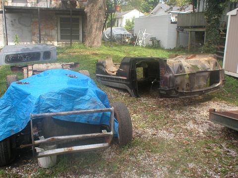

that will probably be all I need for now. I fliped the body off yesterday, so I am now ready to start the tear down of the BII. hopefuly I will get the body setting on the frame by thursday.
- Attachments
- bronco tear down 30.JPG (42.83 KiB) Viewed 7895 times
