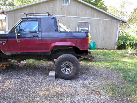

here is what I came up with a few minutes ago for the back fenders:
I figure it might give it that EB look. I need to go get a EB grill also
I feel pretty good about it so far. now that the rear is in the position I want it, I think the other stuff will come along pretty fast. the only things that are going to hold me up are other people, waiting on parts and of course money. I am trying to take it one step at a time and just deal with the issues as they come up.

here is an update from today, ran the fuel lines, mounted the battery and ran the power cables, and wired the motor.
pic of the rear:
pic of the rear:
