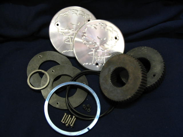

Well i dont want to be stuck in that hole again because of a stupid hub so i bought some drive flanges for 155 bucks. I like the image

i dont think dana 44 slugs would work on my dana 60 with 35 outers. And these were the cheapest set i could find it was just a bonus they had the cool art on them.

i know people sell the bling sets for the 44. I just go the cheap route. I love my drive slugs,
didnt realize you were runing a 60, dont thing theres anything cheap for those.
so these take the place of original hub's? im assuming there stronger but why?
Yeah these were the cheapest ones i could find. The reason i went with them is because the warn gold hubs i had would break the mecanisim that pushed the two hub peices togehter that kept the axle locked. So i got stuck when it broke. My friend has broken two already and went to the drvie slugs and never had a problem sense. I never unlock my hubs so i got fed up with the stupid hubs. these are way stronger two so it will be nice.
