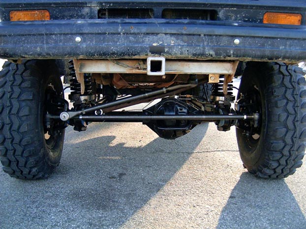

post some pics
here are some....
coil bucket.jpg (11.51 KiB) Viewed 5793 times
