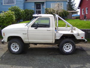

I would have to wonder if the cab will hit the rear tire. If I remember right that the rear tub wasn't to far from my front seat. If it works go for it.
The more I think about a Ranger cab on a Bronco frame, the more I like the idea. I have a complete parts 84 B2 and two parts Rangers. The plan has been to junk out the left over rigs and parts after I'm done with my sons B2, but now............
I have thought about a ranger cab on a BII frame and just four link the rear and put the cab mount where it needs to be. but at that point you might as well just cut up a ranger and do what needs to be done with that frame.
I measured the Broncos cab mounts Vs the Rangers.
You are correct the Rangers rear cab mount will be directly over the front spring mount on the Bronco frame. The top of the Rangers rear cab mount is much higher than the B2 though, and it looks like it would be no problem to relocate and still be able to get a nut on the bottom side.
My son is going to start taking the body off the B2 this Friday.
