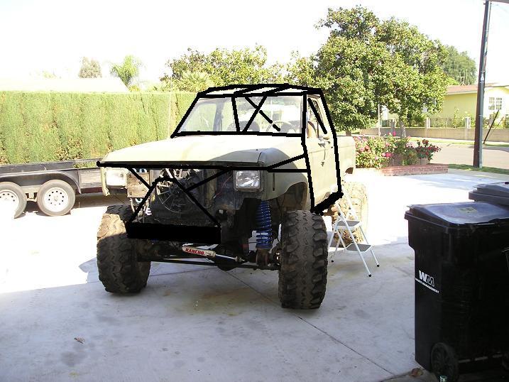

this is what im thinking about for my EXO.... what do ya'll think?

are you going to put any around the rear?
was'nt really planning on it but if i have enough money for the tube i might tackle the rear section . my main concern is the cab section the front will get done if i have enough tube. i figure as long as i have the cab done i can wheel and feel safe ya know.....
I like what you have so far......what kind of tube you going to use?
the wall will be .120 i think that's what we used on my buddys scout. the dia will be 1 1/2" or 2" have'nt descided yet have to look at the 1 1/2" tube.
thats kind where I am at....I know I need a cage but I just don't know what I want protecting my head. a friend of mine dad owns a shop that has a bender in it I just need to get my mess together before I go over and start a mess at his house :laugh:

1 1/2 is pretty small and 2" is pretty big 1 3/4 seems to be the ticket for a cage (main portion)
how do you intend on attaching to the frame?
4 or 6 point sliders and the front will be connected to the hope i the front. im not sure if im gonna make the sliders out of square tube or round. i like the look of the round tube but we'll see.
