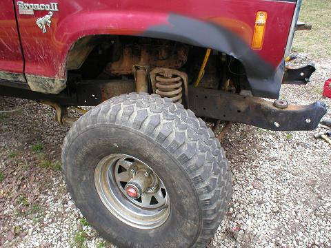

it came out ok, but it could be better......it fixed the problem I was going to have with the tire tucking into the rear anyway.
I kinda hacked the front, guess that just proves I'm not a body man......

well, I had planned on just painting the truck flat black so the fact that I wrinkled it isn't that big a deal. but I did do something similar......I basicly drew out where I wanted to cut the fender then offset an inch lower. then I cut where I offset and then folded the lip up link what phillippi is talking about. I just had a situation that the metal was in a bind so when I went to beat the lip over with my body hammer the fender twisted in the seam where the flare is. it looks fubar but it will work and I think if I put one of those rubber flars over it it will look ok......but like FSB said its going to get smashed any way........
yeah, I am planning on having to cut more once I get to where I can flex out the suspension.....hopefully it will be soon. if you want to come help your welcome......
be very carefull with the sawzaw.....using them gets addicting, next thing you know you will be cutting everything up to alter it
I had ALOT of fun cutting up the 79 body.......

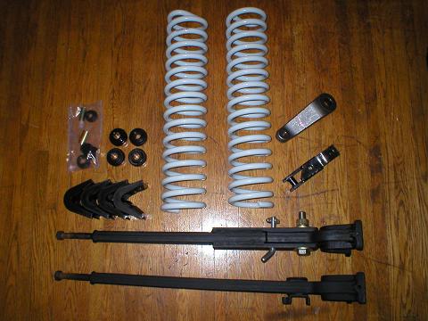

well I finaly have an update........but I haven't done anything but spend money
this is basicly everything together, the only thing I have not gotten yet is shocks and I was wanting to get the suspension together before I just buy something.
I compaired them to the stock one's and there is a big difference.
stock = 17 uncompressed
superflex = 24" uncompressed
monday is when I am going to get them in, if I have enough time I am going to start on the steering also.
