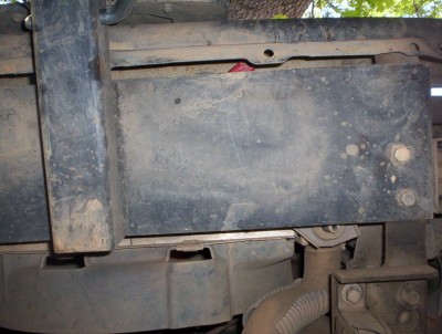

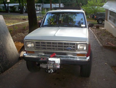

the winch is on a 2" reciver, I put a plate of 3/8" steel across the frame and welded the reciver to it. Paradise is 100 miles north of Sacramento in the foot hills east of Chico.

I started by getting the measuring the frame from left to right and how far back i could go. Then welded the reciver in the middle and picked up the holes that were in the frame. You can see form the pics. Some things that i will do later on is a locker in the rear and more lift (someday). I will alos put a reciver in the rear and run the power cable so I can use it in the front and rear.
