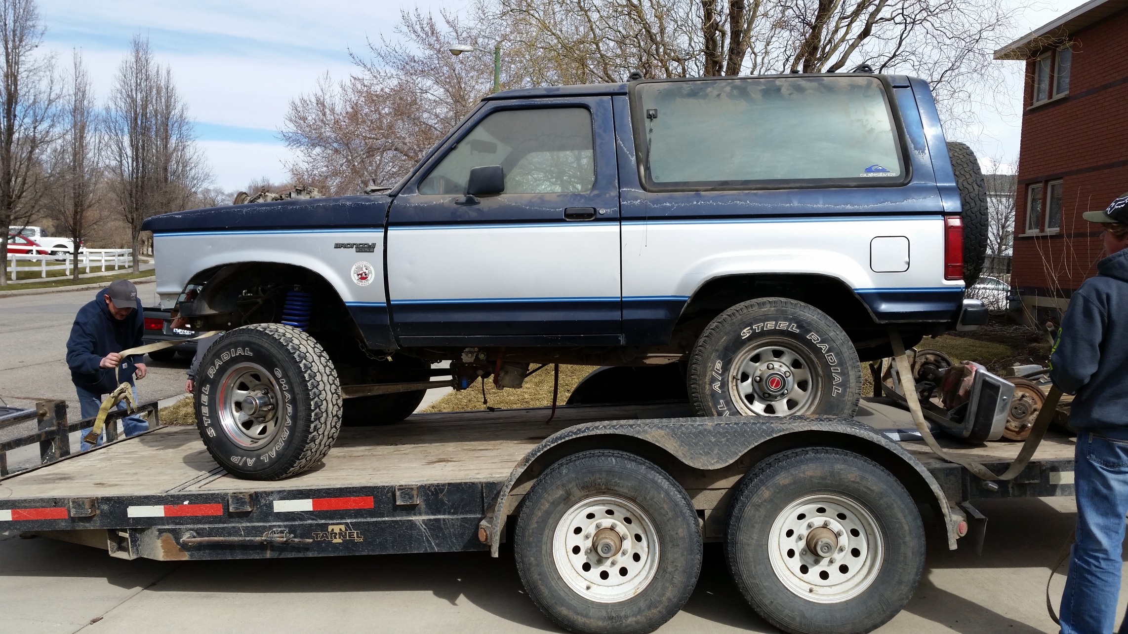

This is an old build. Springs were flat. So I put explorer leafs and removed the lift blocks and put a stock shackle back on.
Sucked the front down with the winch and added a center limit strap.
Hoping this will stable it up a good bit.
Here is a before...
