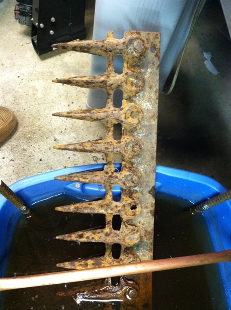

Here we go last couple of Pics on the Electrolysis Tank. This last part the Sickle Bar has been done. I am still impressed with the overall operation of the tank. I have however run into a slight problem.. It seems my steel screen idea wasn't as good an idea as I thought. I figured to get the junk off the screen by just scraping the crud to the ends where there is room for the sediment to fall tom the bottom of the tank!
It was a good idea in theory. The problem is I forgot about the rust attaching to the steel anodes. First try to clean off was less than impressive. I finally fished the plate out of the tank and cleaned it with a wire brush. The plate shows a lot of consumption of the steel. I may look into using some carbon fiber sheets I have heard works really well. All in all not bad for less than $50.00.
The untouched part of the bar
After 48hrs
Big difference between untouched and soaking 48hrs
You can actually read P/N clearly on the tines.
