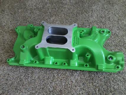

well this summer defiantly changing out the intake manifold and going from an Edlebrock carb to a Demon carb!
just got done painting the intake I ported out I had laying around

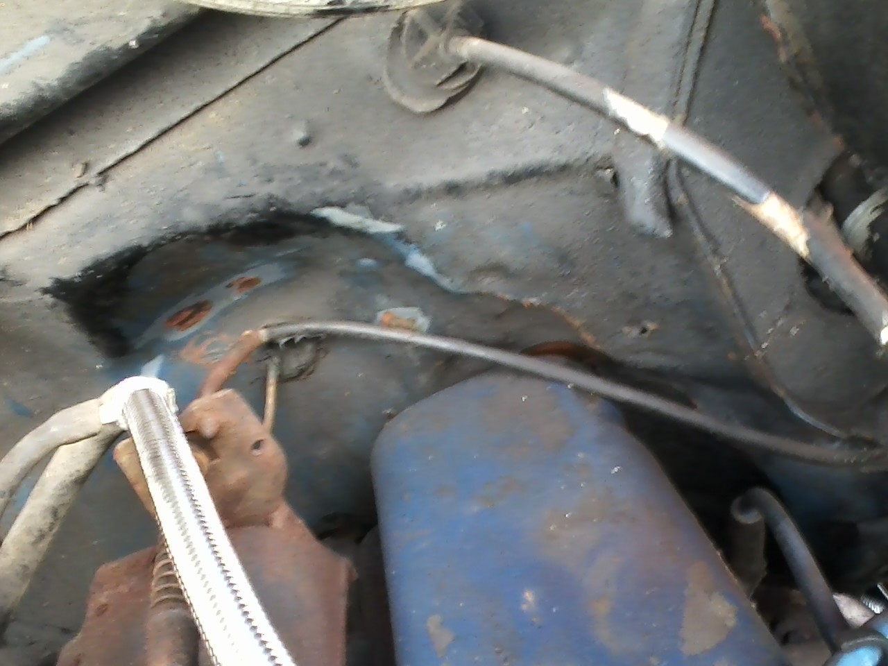

more notes!!! when I was removing my heater box I noticed that A the nuts on the studs for my housing were solid rusted to the studs and B turning in their place, now this is only the two outer bolts not the one inside by the heater core, but anyways I used a cut off wheel cut the nuts off the studs and their is a inner nut on the firewall I left that one but ground about 1/3 the nut thickness down I bought 2 bolts and nuts that were exactly the same thread and left the same stick-out ground the allen heads down to about 1/2 of the thickness and welded them onto the remaining nut on the firewall also tacking the nut to the firewall and defiantly was worth the time!!

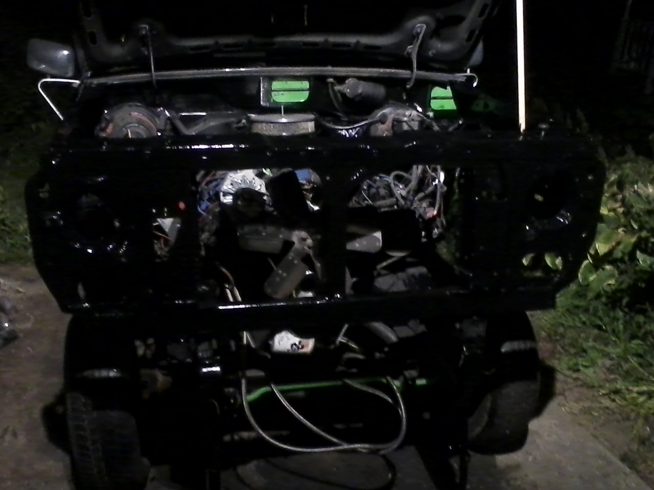

Well ever since I have had this vehicle the front bottom of the core support has been kinda in bad condition last year you could really tell from the body mounts so this year I decided to cut the bottom of it off and take the lift blocks out and just replace it with 2 by 3 1/8" wall tube and add some gussets along with fix my cooling problem, O yes I don't wanna forget I also re located my battery box with an aftermarket one from allstar for 23.00 through summit racing you really can't beat the cost it also fits my optima battery perfect! Im also trying to simplify things on the vehicle to same time in the future when I'm working on it! Another good tip for all you insane people that have put v8's in ur machine best thing I ever did was take the fenders off to work on the side of the engine it will save you a lot of time and reduce the amounts of times being pissed off lol....you just get so much better access! Ok so the cooling issue ever since this v8 has been in the vehicle the radiator worked ok it was more square than rectangle was covered by a lot of factory crap in the way such as bumper parts of the core support stuff like that it was just not getting proper air flow I really don't like the factory sized hole so while I was cutting the bottom of the core supper this was optimal time to widen the hold what I did was you know where the core support has the two runners going down that meet right by the bolts in the front to bolt it down well I cut all the way to the second runner overall it gave me I believe close to 5-6 more "" for cooling space and this allowed me to put the brand-new radiator I stole out of my full size bronco (this radiator is a 2 row HD radiator for a 5.8L only) so from the info I just said this will more than sufficiently cool! You also have to make your own custom mounts and relocation holed for the radiator for my mounts I used a couple of gussets on each side and cut one face off of 1-1/2by 1 1/2 1/8" wall tube and to mount is used ss lags. Now the battery box was arguably important to relocate because it's closeness to the radiator, but they also are kinda flimsy and I wanted more space to work because I'm tired of hitting my hands on stuff remember I'm trying to simplify! Also when I cut the base of the core support off wouldn't you know it the mounts on the frame were bad too so best corse of action was to build new ones and save my self wasting money buying ones that were inferior to the ones I made! Best material with in reason to use was heavy wall (3/16) 3" by 3" tube they worked out soo good! I will try to keep every one up to date this year because I have no choice but to make this vehicle legal this year!! I'm also using rust bullet gloss black paint doing 3 coats of it!

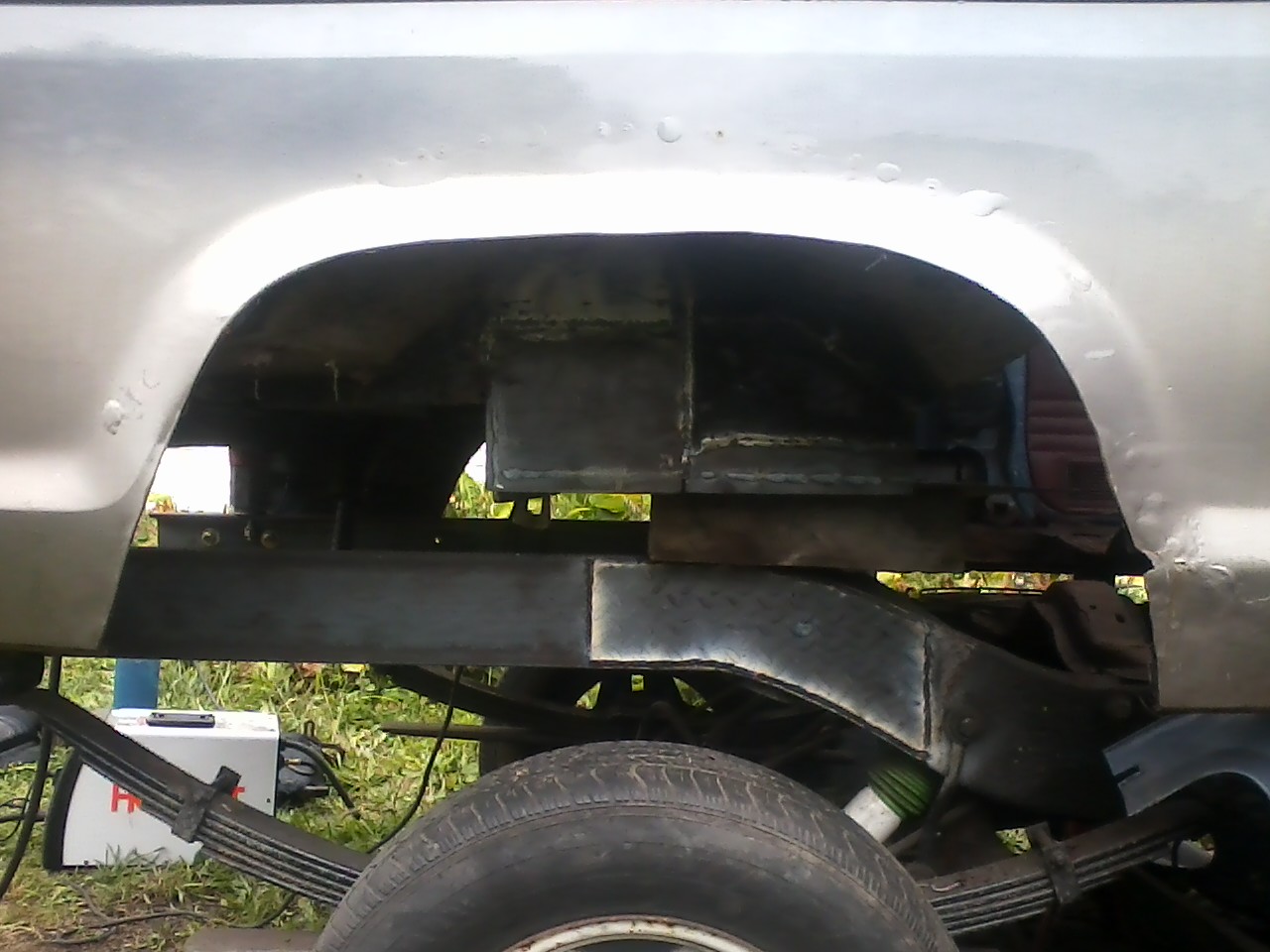

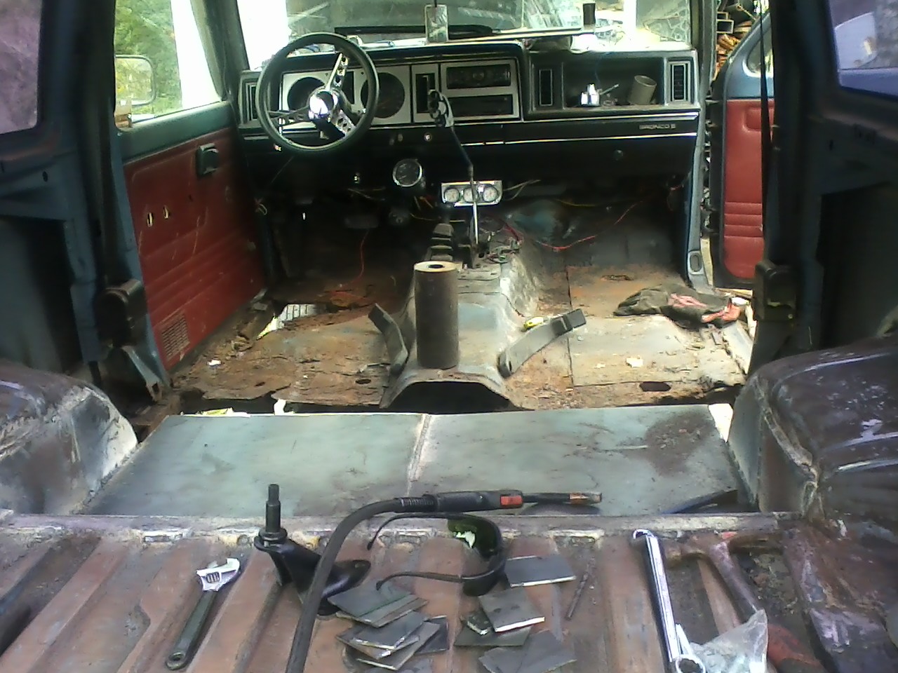

Well hopefully I can get some more pictures up soon and add some depth to them but I've been quite involved at working on my Bronco II the past couple months between changing the rear 1/3 of from by using 5" c channel or replacing about 3/4 of the floor it"s been quite involved but heres a couple

You Could significantly improve your cooling by putting some sort of shroud around the fan. A shroud could improve cooling better than 50% and especially when running at a slow speed.
