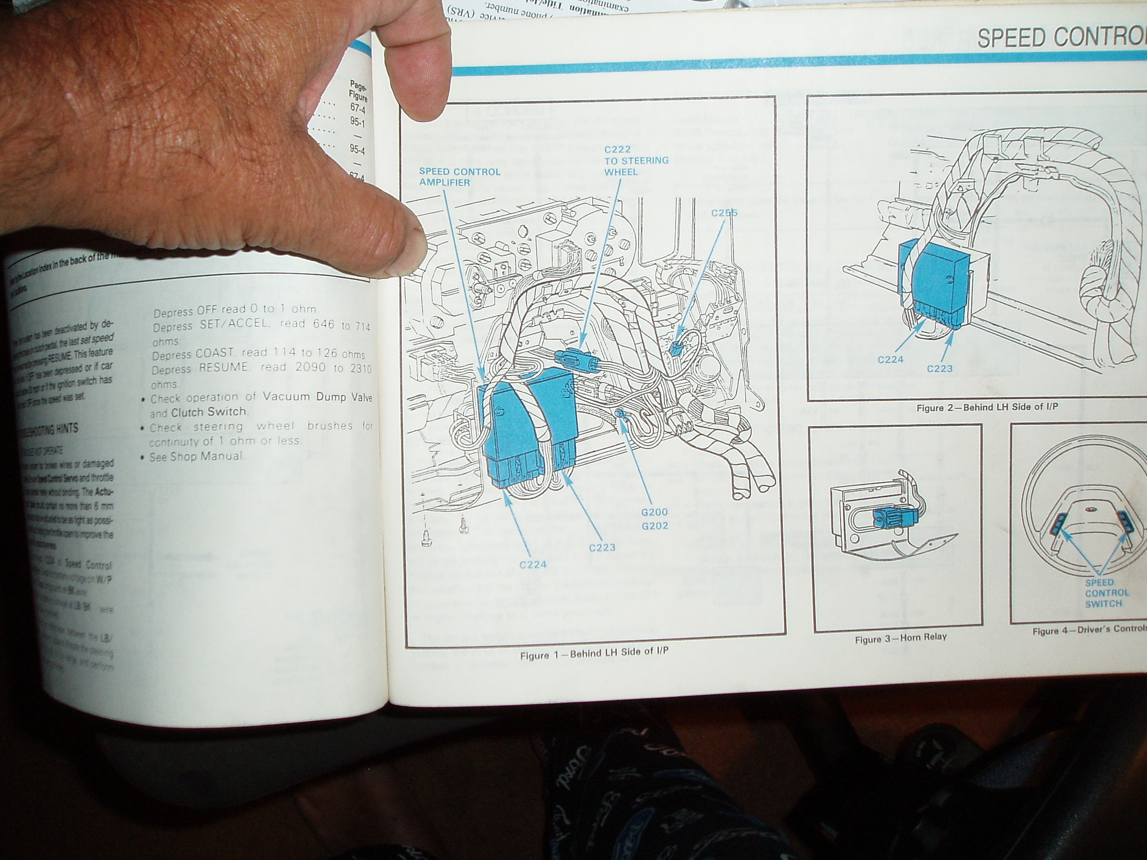

They share a ground but you would probally wounldn't have dash light also. it the G200 on the attachment
