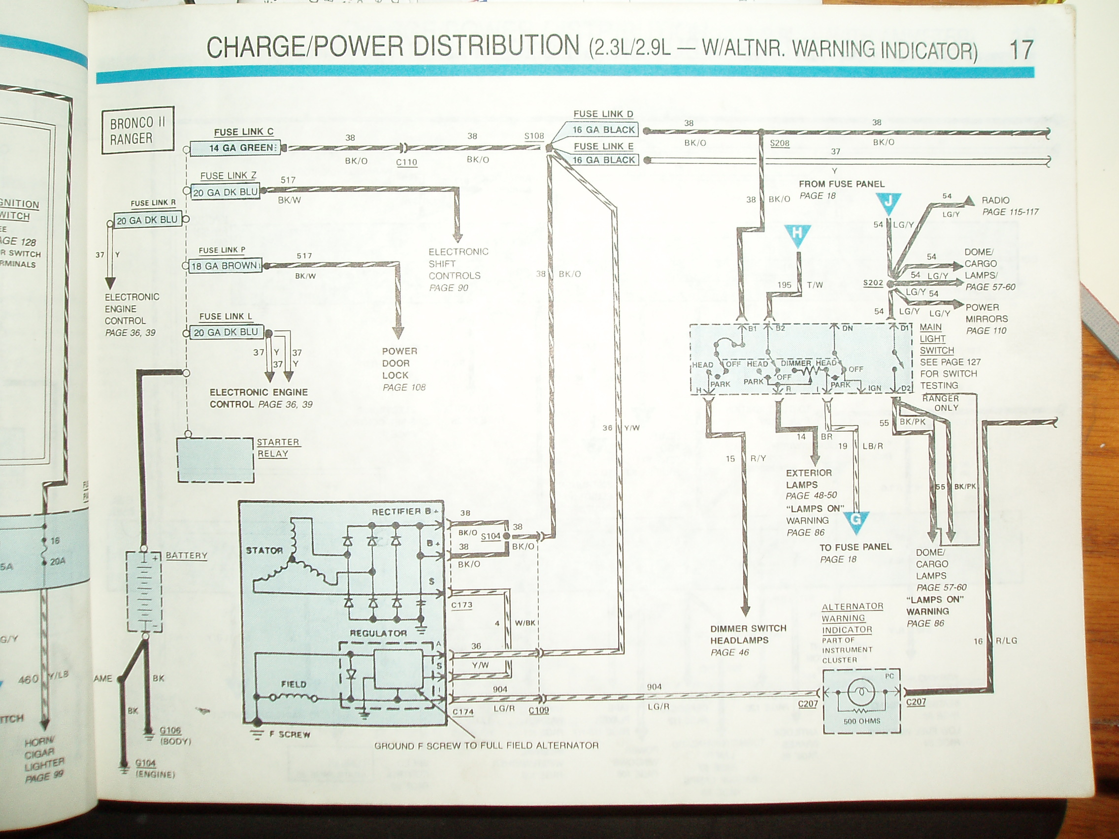

the blk/org wire coming from the alt to the starter silinoid had a black fusible link on it with 2 wires goin in and one coming out.. i tried a 14 and i think a 12 gauge and nothin happened. ( i got these at autozone, one was 1 wire goin in and a mountin ring on one side and the other was one wire in one wire out)

Time to trace wires

dude thats way more helpfull than my chiltons, judging by that i need the 16 gauge black one, thanx!!

nope, 14 GA green. fuse link C

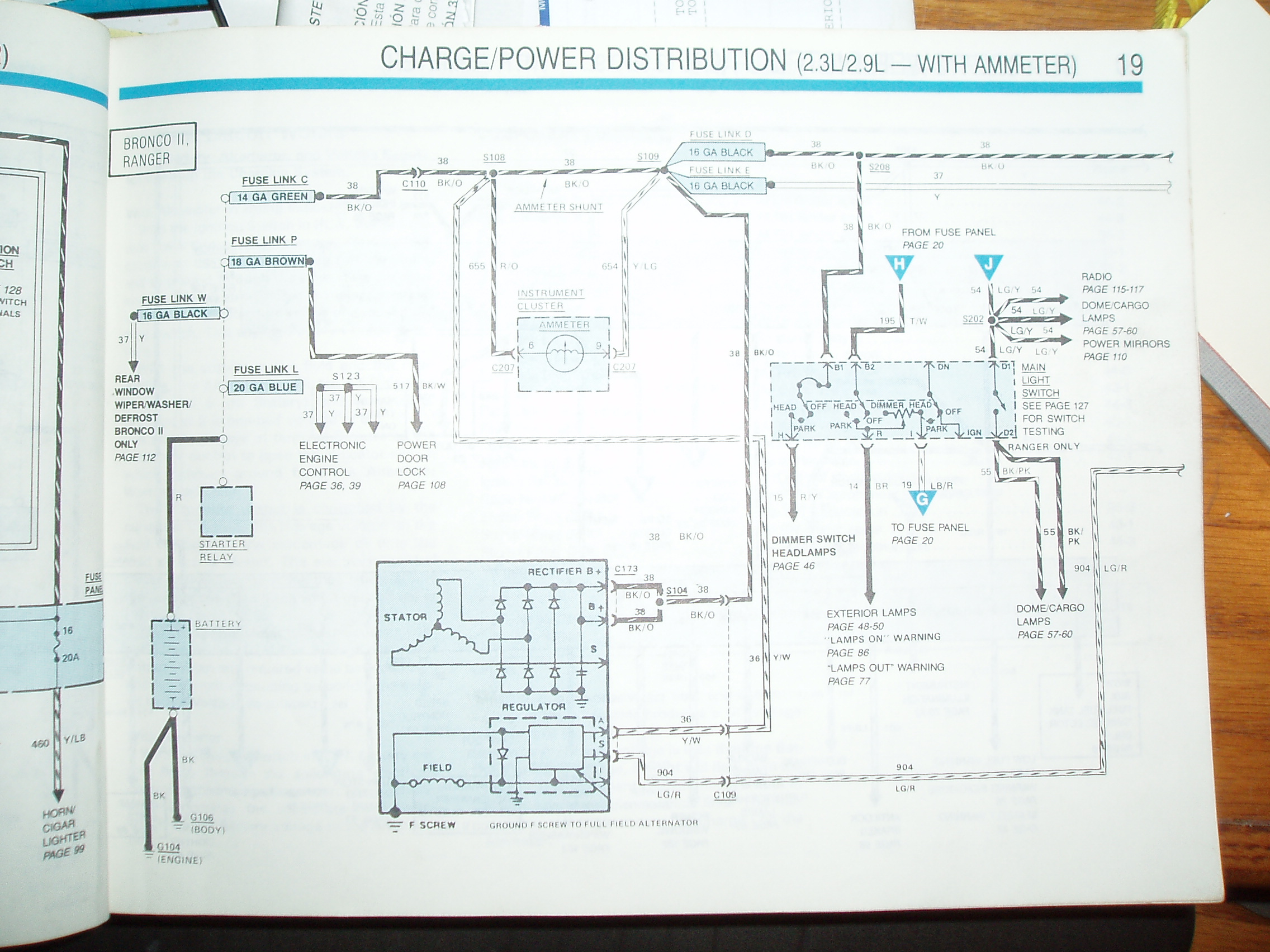

mine was the black one the 16 gauge , the green ones fine, my black one fell apart

If you look at wiring diagram with ammeter the black 16 GA (fuse link W) runs the rear window washer, wiper and defrost. NEED TO CHECK POWER AT ALT!!!
