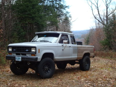

heres a 4in suspension lift with 33's

gonna have to regear90redb2 wrote:Would I be able to clear 33s?
Re: body lift question
Hmm. Maybe I'll get a 2 inch bl and run 31s cuz I don't want to regear. And 33s would prob rub at full turn cuz I'm running stock rims with no spacers.
