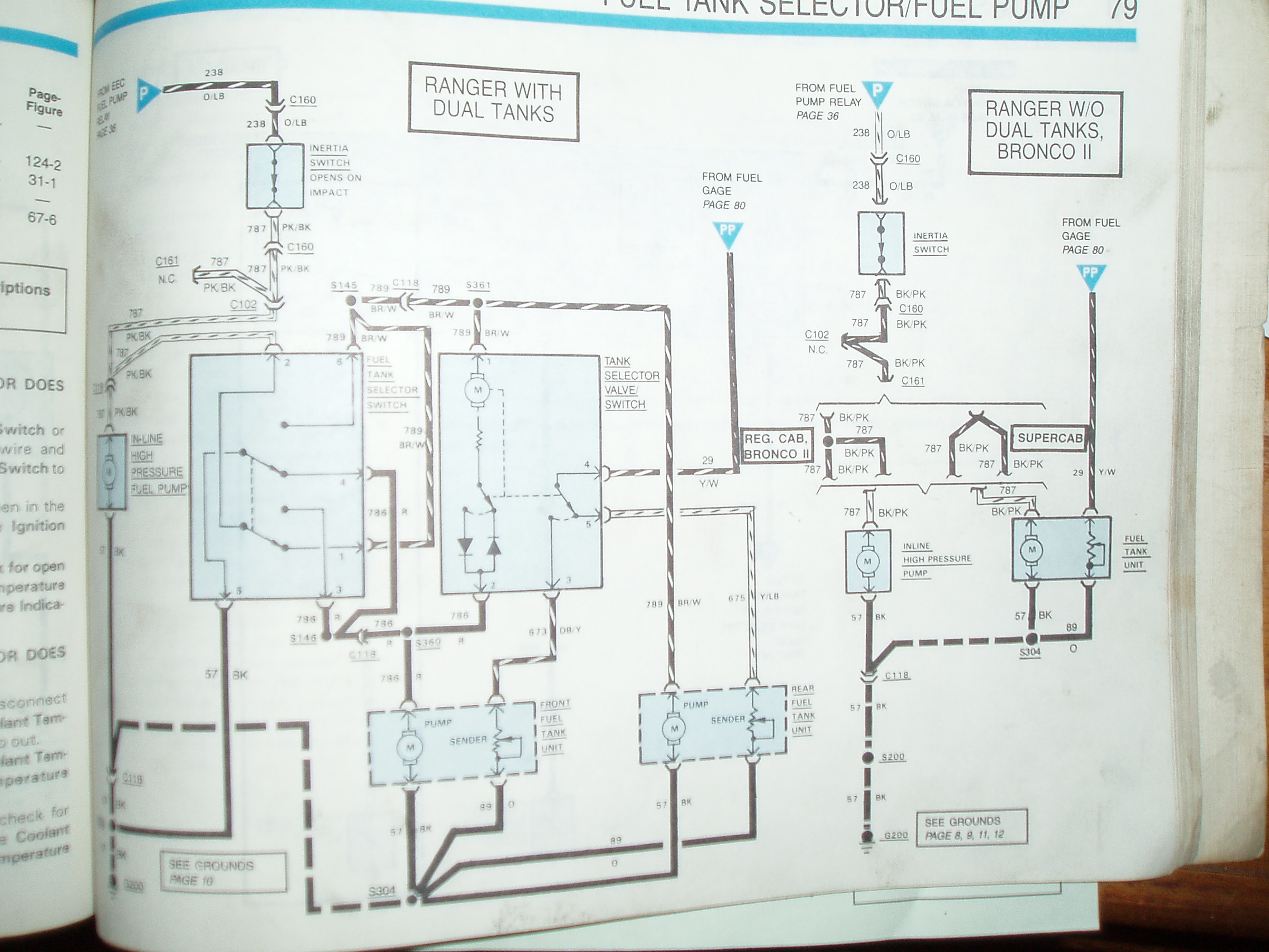

Re: Gas gauge questions.
An IVR (Instrument Voltage Regulator) can effect the gas gauge but it will effect other gauges also if bad (temp, oil pressure). Most of the time it’s the sender but sometimes it’s a connection or ground. The main body ground comes off the Battery to the Radiator core support. As with any Voltage problem there is no “this is it “ solution most of the time. Check out the attachment. I lucked out with my gauge problem cause my lift pump went out and when I replaced it (it came with sender) my gas gauge started working. This wiring diagram is for a 88, later models may be different. Happy Ohms law.
