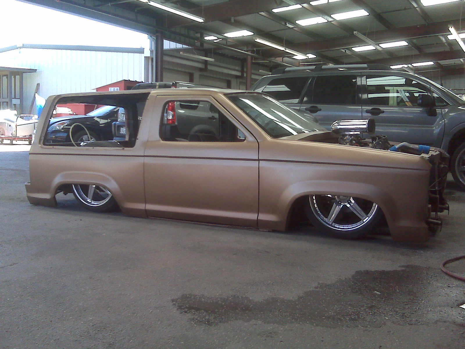

Well, i really don't know were to start. my truck has had it's upgrades through the years...... i gues if you want to know more about it you will ask. so here are a few pics to generate some questions,,,lol

Ranger Dave wrote:how bout some spec on the B2
Well were do i start,,,, the engine is a 1972 302 Mexican block that has been bored, the crank has been ground and balanced,it has flat top pistons and the cam is massive. the heads ported polished and gasket matched as well as a 3 angle grind.it has a edlebrock single plane intake and a holley 750 double pumper, i run a Msd 6al with a 7200 chip unless my wife is driving and then i put a 5600 for her,,lol.it has a 5 core radiator mounted in the back from a combine with dual honda fans and i ran copper pipe from the front to the back. it has a full rollcage interior.2 summit racing seats and 5 point harnesses.the dash is a aluminum panel with full instrumentation and switches.a 8 gallon stainless fuel cell.

Postby Ranger Dave » Wed Mar 03, 2010 1:08 am
44 and a 9in?? tranny??

Postby UFOSPY » Wed Mar 03, 2010 3:13 am
oops,,, it had a ford 9" rear with a full spool posi 4:10 gears and the front was a dana 30.lol again 4 :10 but i put yukon ring and pinion in there which seem to of held up, i blew a lot of ring and pinions until i changed to yukons then it was ok... the tranny was a 3 speed manual. i am now running a sbf c-6 auto.

Postby Ranger Dave » Wed Mar 03, 2010 2:38 pm
EB 30?

Postby UFOSPY » Fri Mar 05, 2010 6:40 pm
dana 30 before 1972 dana 44 after 1972
