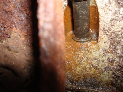

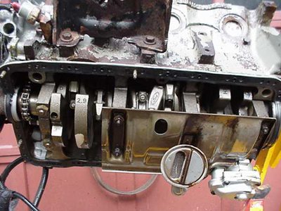

THE TUBE RUSTED OFF FLUSH ON THE OUTSIDE OF THE BLOCK DIDN'T SEE IT TILL THE NEW TUBE I ORDER COME IN AND IT WAS A COUPLE INCHES LONGER. HOW MUCH OF THIS TUBE HANGS OUT ON THE INSIDE OF THE BLOCK? I JUST PICKED UP A PAN GASKET AND WAS HOPING I COULD KNOCK IT OUT FROM THE INSIDE BECAUSE THE MOTOR ONLY HAS 80,000 MILES ON IT,RUNS STRONG. IF I HAVE TO PULL IT OUT TO PUT THE DIP STICK TUBE IN I WILL WANT TO REBUILD IT INSTEAD OF BUYING A LIFT KIT OR DOING A S.A.S.
- Posts: 1435
Re: oil dipstick tube
ya might be able to pry it out with a screwdriver from the out side.
if not if your takin the pan off,push it up through

I, have in the past, (not on a 2.9) tapped the remaining piece down into the pan, then used a strong magnet to move the piece to the drain hole for extraction. This technique works, but is sometimes time consuming and can be real messy.
If you use this method, you will want a very strong magnet to start, place it on the bottom of the pan near the dipstick tube hole, this is to catch the stub when it goes into the bottom of the pan. Then it is a simple process of moving the magnet toward the drain plug hole to remove it.
You already know this, but as a reminder, DRAIN THE OIL AND LEAVE THE PAN DRAIN PLUG OUT TILL YOU HAVE RETRIEVED THE STUB.
