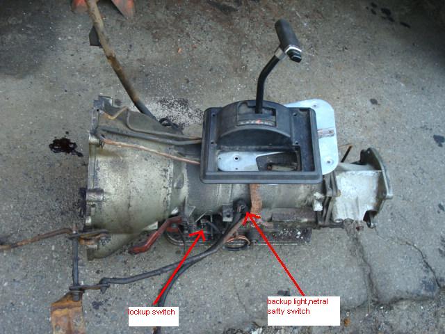

i assume you have both trannys so you can look at them. the 88 tranny will bolt in the 90. look to see how many elect .connectors they have. this one is from a 85, it has one solenoid . sometime in 88 they changed to the dual solenoid versions

right. the 90 is gonna have dual solenoids, the 88 may or may not. another thing to look at is the shift arm on the tranny. i know on C4/C6's theres a difference in them if it is a floor/column shift.

Re: transmission swap
if the 88 has one, that one can be hooked to a switch to control the lockup. im gonna do that with mine.
