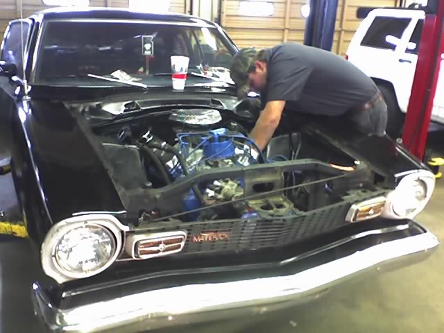

302 swap on the mav
302 swap on the mav

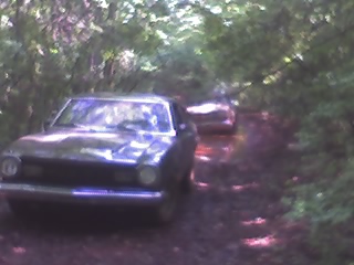

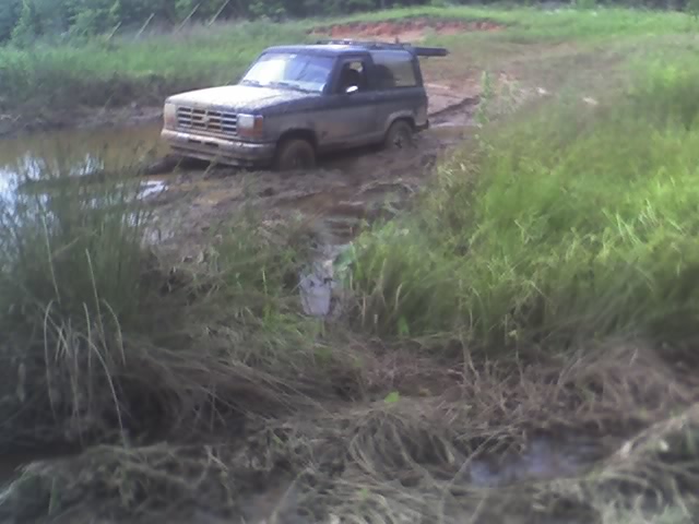

Try to Pull the Bronco out With The Maverick   (didn't work)
