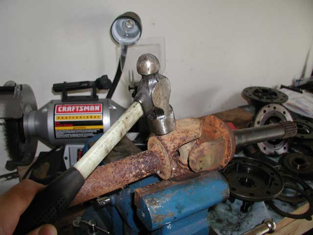

So I need to hammer farther back on the yoke just to jar everything loose? I put a punch on the u-joint cap and hammered the crap out of it, but it didn't do anything. I haven't messed with it since then. I'm thinking that if the one I've got out is this bad, the other two will be too, so I've about decided I'm going to crack open the diff so I can just get all three u-joints out and get my hands on them. There's probably no point in even trying to change the center one in the truck. I've about decided to just dunk them all in an oil bath for a couple of days before I try too much harder to get them separated. I wanted to change the diff oil soon anyway, so I'll just get it done before I button it all back up.Nobody wrote:To remove the u-joints, place the axle in a vise as pictured. Note you are not clamping it, just using the vise for support. Hammer it the spot shown to avoid damaging the ears of the shaft. This works on the most stubborn axles you can find.
One of my problems is that I've never done this before. Another (maybe worse) problem is lack of tools. I've spent over $100 on tools since I started on this little project this weekend. Granted, some weren't really related to what I was working on, but you walk into Harbor Freight and you walk out with more than you planned to buy Unfortunately they didn't have a brass punch when I stopped by after work today, but I did pick up a creeper and a rolling seat (with flames!) along with some other odds and ends. I'll be busy the next few days, so I probably won't get a chance to mess with it much more until next week. I appreciate all of the help!
Basically you rest axle in the vise on the ears of the stub shaft. Then hammer as shown on the axle, not the cap. The axle will go down forcing the cap up. Flip axle over and repeat. Then remove the stub shaft. Then rest the stubbs of the exposed ujoint on the vise and hammer the stubb shaft in the same position to remove those caps.
