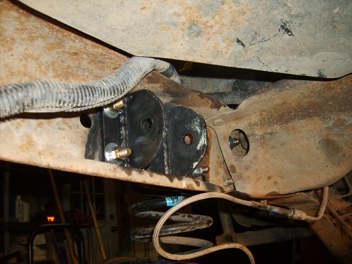

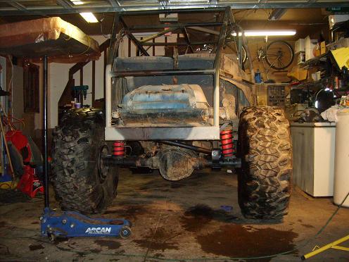

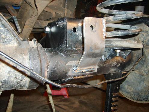

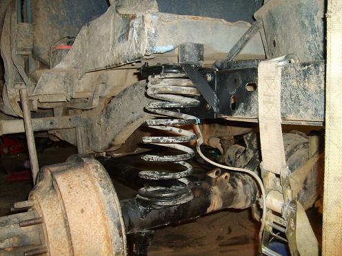

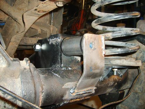

update got the bottom coil buckets in and one top one. just need to do the other side and mounting brakets for the top coil to hold it to the coil bucket.

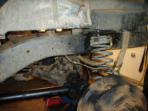

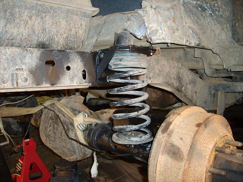

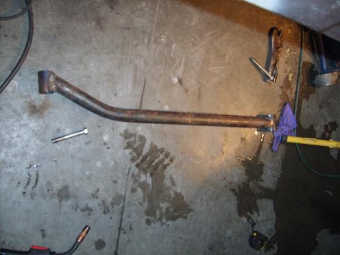

got the coils in after having to drop the old coil buckets down about 2 inches to get the ride hight i wanted . Now im building the pan hard bar and after i do that i will put the air bags in and it should be done till i get new shocks for the front of my dodge so i can use the old pro comp 9000 from it on the rear of the bronco.

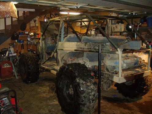

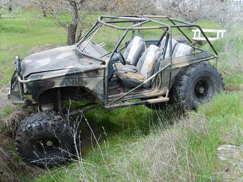

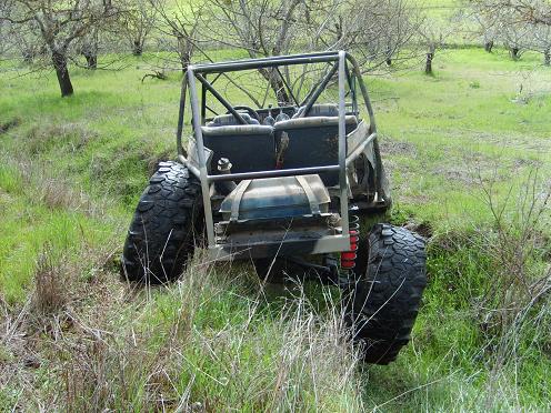

all done!! thanks god! It came out great other then the air bags really didnt work out so i just left them in there but no air connection so they will act like bump stops for hard landings.

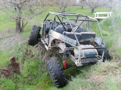

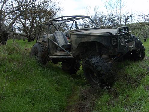

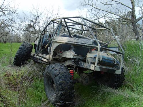

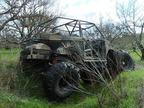

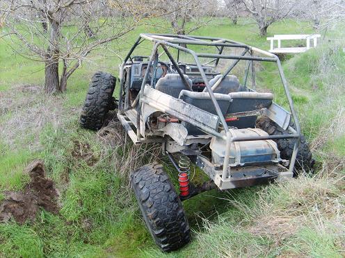

Playing and testing the rear. It works great just need some shocks but that will come in a couple months.
last pic
