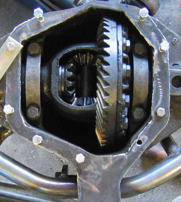

I have a few sets of transfer screws, I don't think I have ever seen anyone else use them. It's an easy way to transfer a hole pattern, I used them on my diff ring I built and got all the holes spot on, thought I would share.

I wish I would have known these existed a few years ago!
