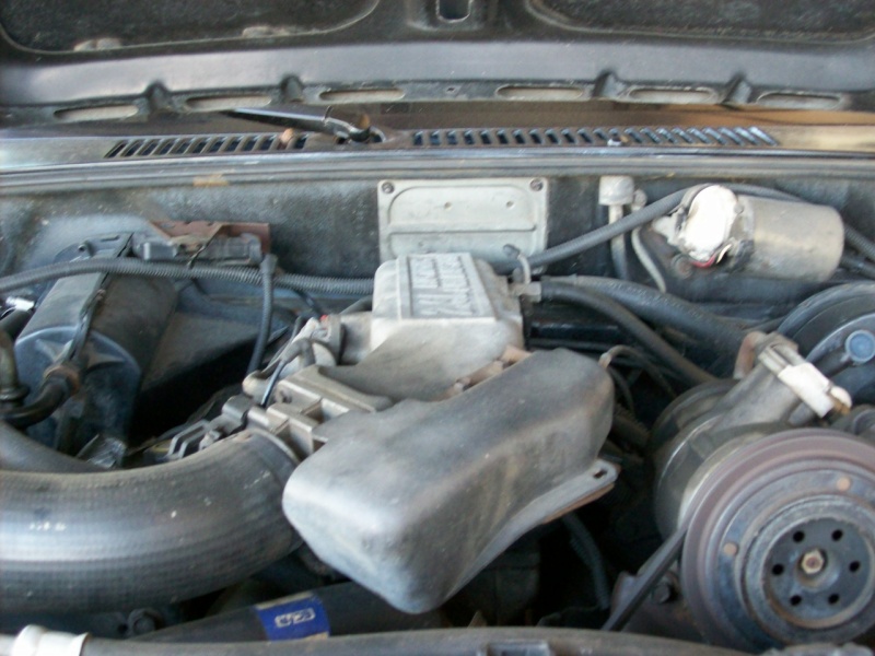

Well, an '88 BII with 70K shouldn't be too rough, and for $2500 it should be a gem without any problems. It looks nice enough. Mostly what you are looking for is basic for any used car, except for a couple items. The 2.9 is a good motor, should start and run smooth and quiet and should have good pull. It's not a race car, but I would equate it to a 4 wheel drive sports car. Check the transmission fluid, if you don't know how to do this take it to a mechanic. It should have automatic tranny fluid in it. The trannys for these are great unless they haven't been taken care of. Any whine in the tranny should be seriously checked out. If it had been run with the tranny fluid low the overdrive is left dry and could disintegrate on you (been there).

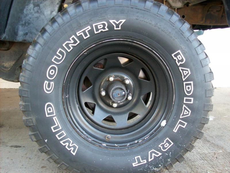

Were the flairs put on there because of rust or clearance? It should run the interstate without any handling problems, does it pull to one side or the other? When you brake does it pull? How much pad do you have on the brakes front and back?
