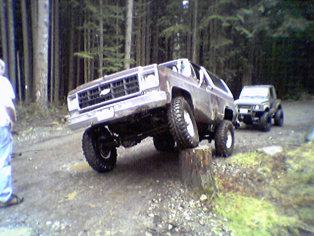

Post by ranger5.0 » Tue Feb 01, 2005 7:40 pm
Here you go. I got the picts of articlulation tests. :redneck:
Post by DBrown » Tue Feb 01, 2005 7:45 pm
it looks good.....is it just me or does the front look like it is not really flexing?

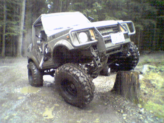

Post by ranger5.0 » Tue Feb 01, 2005 7:47 pm
Sami's turn. not to bad for a camera phone.

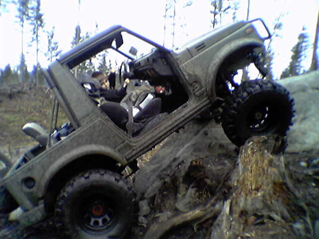

Post by ranger5.0 » Tue Feb 01, 2005 7:54 pm
Ya, the front sway bar is still connected cause I haven't got the extended brake lines yet. Here's another Sami pict. My nephew isn't to impressed with it though. :D

Post by Nobody » Tue Feb 01, 2005 7:57 pm
Damn, he can't even reach the peddles! :laugh:

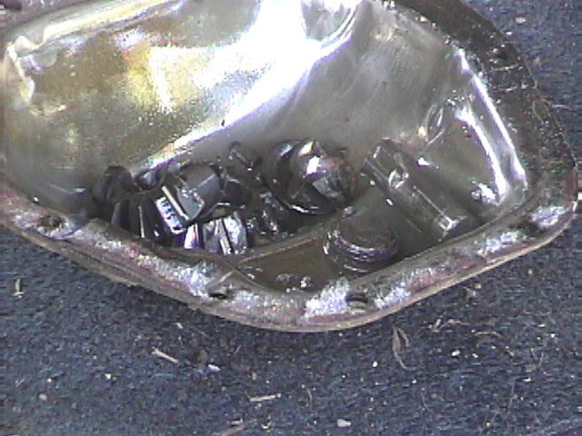

The zuke is always entertaining since it doesn't have any low gears yet. We strip'er down when we get to the trail to build power. I think I saw 35 pounds per horsepower :redneck: . We went and chased a baja around the pit last night. When I went to unload the truck this mornin' I found this :hmmm: . I don't recall any failures or loud noises, I will pull the cover and investigate.
Post by ranger5.0 » Fri Feb 11, 2005 12:04 pm
After exploratory surgery I found the pile of spiders and mangled cross-pin at the bottom of the diff.

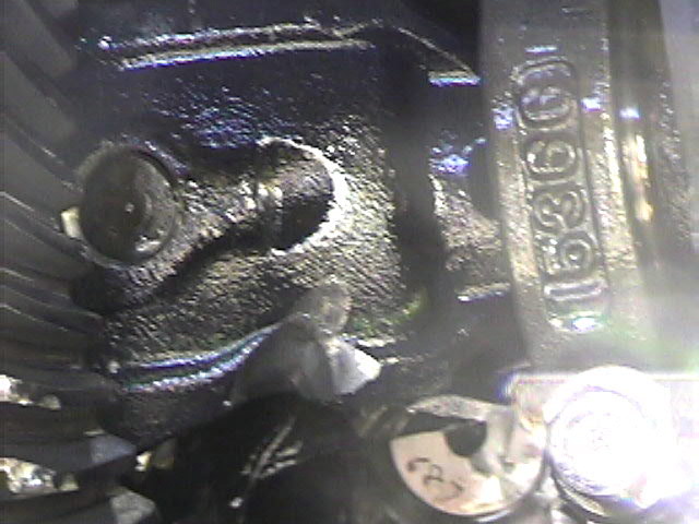

Post by ranger5.0 » Fri Feb 11, 2005 12:10 pm
Looks like the cross-pin failed. If you look closely you will see that the debris gouged the carrier and broke the head off of the bolt the holds the cross-pin in. So the carrier is toast. Now I need to find some 3:73's and a carrier. :wtf: I thought 44's were tough!!!!. I think my dana 28 lasted longer before it blew. :redneck:
