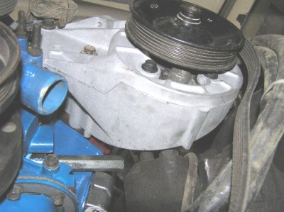

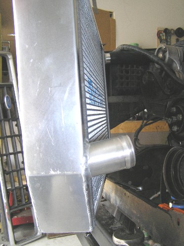

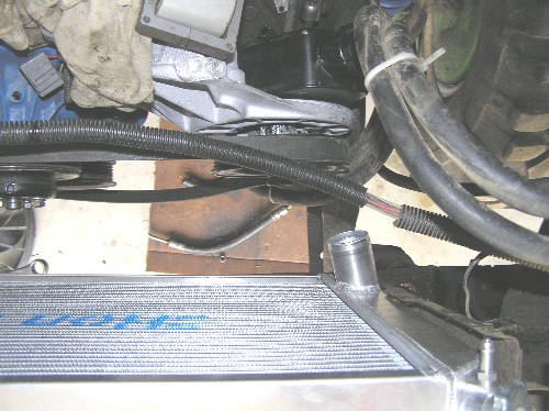

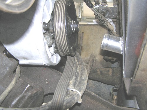

for those of you that did the 5.0L swap what did you use for a lower rad hose? i don't really want any unions in my hose but am havin trouble finding one that will fit
btw i only have 2.25" from the edge of my rad outlet to the pully on my swapped in saginaw pump

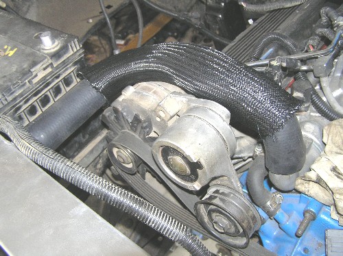

I had to splice 2 hoses together. I really really didn't want to do it at the time, but I was sick of looking for something that would work.
Now 4years later, and a hell of a lot of wheelin and daily driving, I wouldn't think twice about it. It's been working great. In fact I need to do a radiator flush.
At the time, I think I tried some flex hose. It worked to get from point A to point B, but it wouldn't hold shape to clear the power steering belt. The stuff in the link might work a little better.
yeah i had to use three hoses for mine on the bottom.

I had a problem on a previous setup and I took a 1 3/4 x .120 wall bend and cut the inside, bent it more and welded it up to make it tighter. Then I used a small chunk of hose from the rad to the tube back to hose to the water pump. I also welded a bracket off of the tube to hold it in place because it was only about 1/4" away. Worked well for a few years till the entire thing was swapped out.

The hose from the water pump is from a 77 granada (my engine donor). It almost worked, but the radiator outlet was the the wrong size, I think 1.75". I believe it's 1.5" off the waterpump. I think 5.0L are 1.75 off the waterpump. I main reason I had to splice was to get the right size on the hose. I don't recall what hose I used for that. I'll try and dig it up. Does your outlet come off the radiator at a 45*?

i guessi coulda posted pics and yeah my water pump inlet is 1.75"
what i'm thinkin i'm gonna do is use some 1.75" ss tube then tig a bead all the way round to help retain the rad hose i'm thinkin it'll work especially sicne i'm cheap

I've asked my dad to take some pics of mine, it was even close to the pulley but I got it to work without joining two together. I don't even remember how now but I know I did buy like 5 or 6 hoses to take home and try that I thought might work and one of them did. I just went behind the counter at autozone and looked through all their hoses. I'll post pics when/if I get them.
