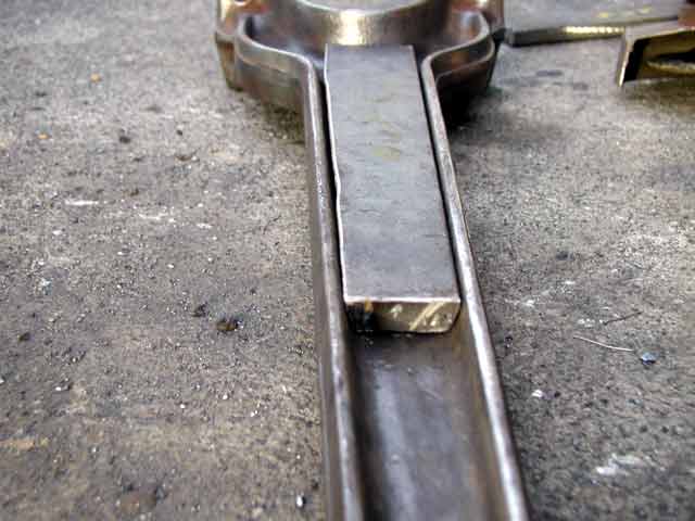

hey nobody i started my arm today did'nt get much done thow. i ground the rivit's off and took a wire brush t the area that's gonna be welded. the auto hobby shop on base out here did'nt have anything to cut the flat sock with so i have to wait till monday to get the steel cut. anyway my questions are
1. when i have the steel cut into (4) 12" pieces should i have them cut 1 of the long sides at a angle to match the arm, or have them cut both long sides at a angle to match the arm?
2. when i bevel the edges do i place the bevel side out away from the channel of the arm or in facing the channel of the arm? should the welder know how it's suppose to be done?

I only cut along one side of the arm. I bevel the inside so the plate will set flat in the arm. Then I bevel the outside a little so I can get a good weld that is flush. If the gap is too big, it takes a bit to fill in.
Once the outside plates are tacked on, drill 2 small holes in the back half of the arm for alignment after you cut the arm.

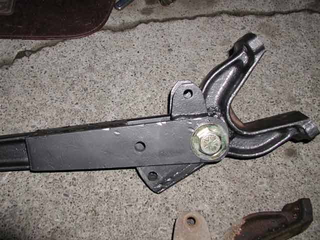

holly crap welder's aint cheap!!! hey nobody im getting my arm welded up this week hopefully it'll be done by the end of the week. the guy that's welding it wanted to know how far yo drilled the 7/8th hole from the wedge and how far you drilled the 5/8th hole from the centerline of the 12" plate. i told him it really dose'nt matter but he want's to get it just like your's.
Well, you want the pivot bolt as close as practical to the wedge. I basically placed the large flat washer on the plate and used that to determine where to drill the hole.
For the lock pin, Put it sort of close to the pivot bolt. It will make it easier to pin. My first arm was spaced a little to much. Again, no real measurement, just wing it. If it's back too far there's a chance your tire could contact the pin at full lock. Not likely on full width though.
Also make sure the shock mount has extra room. Slap a couple washers on either side of the bushing before you weld it, then remove the washers. Don't over tighten the bolt. The shock needs to be able to move.
So what's a welder getting you for? Going rate for a wristed arm is $250 exchange.

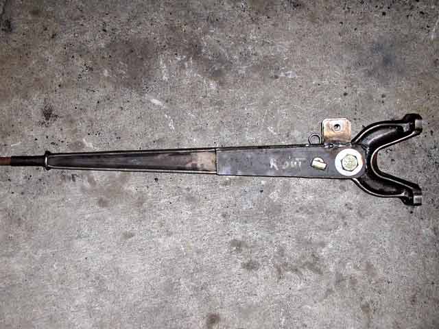

Here's another one I built.
