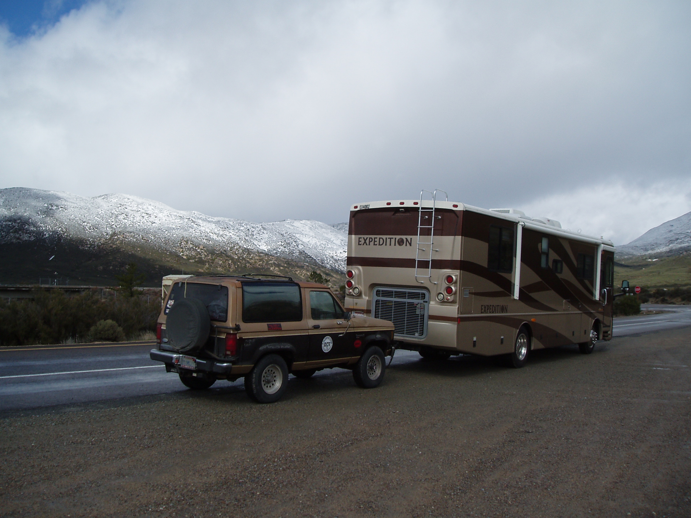

No problem towing it. Put your transfer case in neutral and you transmission into 1st gear. Turn you key to the unlock position but not the run position. The transfer case has a pump in it. Towed mine all the time before the motor blew.
