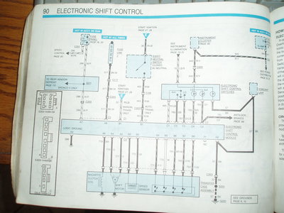

I have an 87 Broncoii and the 4wd "touch drive" switch will not light up, the courtesy light inside the switch does light up when you turn the headlights on. Evidently there is no power going to the switch. I have tried to find a fuse for it but the manual does not identify any fuses for the 4wd system. Is there a fuse and if so where is it? Any other ideas on how to troubleshoot? I bought a used switch because the old one was falling apart but the switch is not the problem. The truck is in 4wd right now and won't come out until I find out why there is no power to the switch. Thanks in advance for any help.

Postby drofman » Fri Jun 28, 2013 8:34 am
Looks like a couple fuses and a fuse link

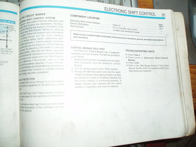

drofman
Posts: 472
Location: san dirgo
Re: 4wd switch not lighting up or working?
Postby drofman » Fri Jun 28, 2013 8:46 am
This one may be clearer
