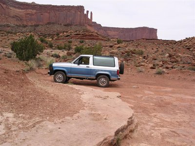

btw nice looking truck. ive had mine since it turned 16. im 26 now and its the only thing ive ever drove. lol
