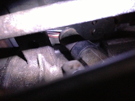

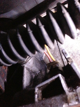

Rightfully so tekatlarge. Thank you for your expertise. My plan of action for it is to pull the governor and clean it real well, replace anything needing replaced on it and then start diagnosing the solenoid. I am still a bit confused on this solenoid however. I have the 1986 A4LD and from what I read there is only one TCC Solenoid. If this is the case, could it going bad cause my no 3-4 shift? I posted two pics (i think anyways) of the two electronic devices I found going into the transmission. Can anyone help confirm what each of these may be? I really appreciate your help on this. I will take lots of pics and post as I do all of the repairs.
Re: A4LD Transmission Will not shift from 3rd to 4th or OD
I think the bottom picture is the neutral safety swt. and the soleniod is for converter lock up only. I'm about 3 beers in so.........We have a tranny guy here that own a shop so maybe he can tell me I'm wrong and quit posting when I've been drinking.
Lol. Fair enough. If that is the solenoid for the converter lock up would that affect my 3-4 shift? Everyone says with the 1986 a4ld that there is no 3-4 solenoid. If that is the case, what would cause no 3-4 shift and a high 2-3 (4750 rpm) besides the governor on the 2-3. I am lost on that whole 3-4 shift.
I don't claim to be a trans guys (auto) but a gov. to me would affect 1st to 2nd also. Again, my advise is free so take it for what it is worth. Sounds like you need to get it rebuilt.
