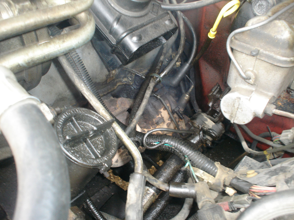

Got to look at it in the light today when I drove it to work, in the 5 minutes it took to get here, the engine was already smoking.... Looked up some stuff on the internet..
Engine smoking, white smoke in exhaust, water coming out tailpipe.... = blown head gasket, probably warped heads too... so the bronco is dead.

didnt really understand your post. picture of motor on stand? if all else fails drive the t-bird.

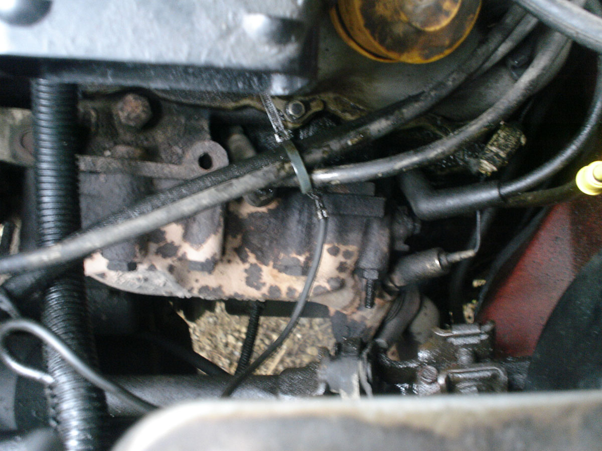

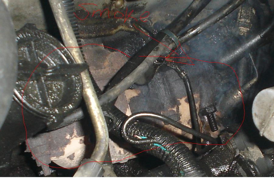

Okay, got off work, she fires up fine, drives absolutely normal all the way home, but obviously something is wrong..
Better pictures and video for ya:
Video: http://tinypic.com/player.php?v=125gsd5&s=5
The red circle.... I did see something wet come out around the ring of the bolt, and drip a little tiny dot.
So what can you tell a vehicularly retarded person about this...

dont that motor sound bad,adjust those valves!!!. the smoke from the exh manifold looks oil burning off. whats the temp where you live??

I was thinking oil off the valve cover gasket. Is the smoke blue and stink? That's oil. I read your other posts, the brownish thing that gets hot is your exhaust manifold it gets real hot!!! If oil drips on this it will smoke like nobody's business.

The smoke from the exhaust manifold, well color-wise look at the video, it looks white to me, could have a blue tint, smells like death.
I'm sure the engine itself was on it's way out when I bought it, paid $450 for the car, it's a little sluggish getting from 0-25 then i'm normal from 25-45, then sluggish again, say I'm driving to the dog park, there's a long steep hill, if I hit it at the bottom starting at 60mph, by the time I get to the top I'm only going 40 or less mph foot to the floor. (before any of these problems started)
So you guys are thinking it's what, bad seal between the manifold?

And I thought burning coolant was supposed to smell sweet? In the picture I circled the bolt, I'm pretty sure I saw black liquid come around the base of the bolt, and a drop form of the bottom left side.. So if it's not just at the seal, I'm gonna guess I need a new manifold too.

uh yea man...i see some blue tint in that smoke. What happens under the hood when you step on the gas? Do you get more smoke? I also don't think the smoke it's coming from that screw...but hard to tell from the vid

Ya it was right after I quit recording that I saw the liquid come through the bolt, but I mean obviously, that isn't the only leak since there's smoke everywhere
