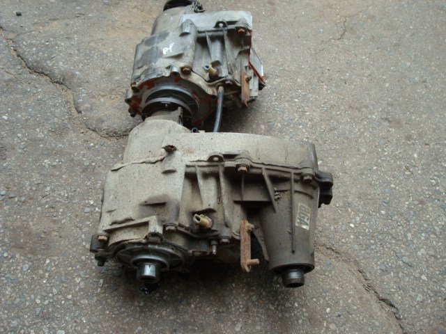

I'm just about through with my automatic to manual swap and I need to fill the transmission and transfer case with fluid. What grade ATF do I need?

t-case
83/87 dexron II
Fm145(83/87) 80W
FM146(88 on)80W
Posts: 1430
Re: Trans fluid in trans and transfer case.
Post by Ranger Dave » Sun Feb 14, 2010 5:29 am
the t-case needs the ATF cause it has a pump in it
the 145/146 dont have pumps, but the M5OD has a oil slinger so that(M5OD) takes ATF

Many thanks Ranger Dave. I'm glad I asked. I would have put atf in both.
