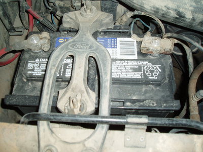

check the smaller wire off the Neg side of battery, not the cable but the smaller wire.

there should be atleast 2 wires off the neg side of battery. one to body ground and the other one i was talking about. as you can see from my picture i had to fix the one i'm talking about.

drofman wrote:there should be atleast 2 wires off the neg side of battery. one to body ground and the other one i was talking about. as you can see from my picture i had to fix the one i'm talking about.
not to thread jack, but that smaller wire on mine has already been cut and reconnected by someone prior to my purchase, however the wire itself is broken (read: rubber split with wire hangin out, but still working) - should I just cut the wire and cut out the bad part and reconnect or can these wires been purchased and installed as a whole? I have no idea where the wires leads to or what else is connected to it though. Thanks for the pic drofman.
1990 Bronco II 4x4 2.9 auto
drofman
Posts: 487
Location: san dirgo
Re: Bronco II-no power
Post by drofman »
you can just cut the bad part out, save you money
