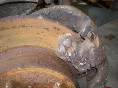

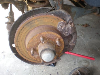

here are pics when i got the wheels off. What should i replace and what can i clean up?
Re: 88 bronco 2 brakes help
2wd? Those are rare around here. Anyway I would start with rotors, pads and new rubber lines. I would also clean up those calipers as good as you can. I would assume that the drums look the same. I am guessing that they would also need replacing as well as the pads, cylinder and ruber line as well.
When I got my BII, I had to replace all the brakes. I had to put on new rotors($40 each from advanced) becuz one had a crack in it and u have to replace both sides at the same time. I put new pads on it($20 for both sides from advanced auto) I ended up having t replace the calipers too, they were shot and the pistons weren't going back in no matter what I did( I think they were 20 or 40 each but there was a 10 dollar core charge). I replaced the shoes on the rear (20 for both sides) A piston on one side ($15) and some little cable thing ($3) I also replaced both rear lines($3 forma local cheap store) but I had to get adaptors from an auto part store for them to fit ($5 each) I also flushed all my lines. So now my brakes are good. My rotors and calipers looked just like yours is the point of my post. I should have just said replace them, haha.
+1 for tekatlarge
Brake inspection and replacement of all the parts that even look suspicious is imperative.
From what I saw in the pictures, I would replace everything from the steel brake lines on the spring buckets out.
The parts are not that expensive and will save lives.
You must live where they use salt in the winter, I have never seen brake parts that rusted.
