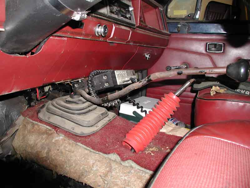

hey matt, how is your shifter bent? i think i finaly got this fawker figured out, and the way my shifter is bent, its a pita to shift. just wondering how yours is bent up and how well it works? thanks
Posts: 2232
I don't have a body lift, so I had to do a really tight bend. I could have cut the dash, but I didn't want to.
You want the shifter to come off the tranny a slight angle say between 6 O'clock and 7 O'clock. That way it flows through the gears nicely without the tendancy to hit 1st instead of third.
Mine is actually very comfortable to drive and shift.

ok, ive got the 2nd gen so my dash is a lil different, but i cut most of it out anyway, and will make a custom one some day. right now my shifter is bent to far down towards the back, ill bend it up some tomorrow and see what i can do. thanks for the help
